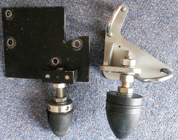

The problem with the OE solution of limiting suspension travel by fitting a chunk of rubber under the 'hoop' for the Differential casing to hit is flawed from the off...
The hard rubber pad is not progressive (it was not even fitted during build on my previous S1 Roadster) As we all know the axle is highly unlikely to travel an equal amount each side as it hits a bump, ie stay horizontal So, in real world driving, by the time the hoop bumpstop limits travel, the wheel travelling up into the arch will be allowed to go too far up hence the witness marks in peoples photos This also concentrates much more load onto one sides leaf spring & shock absorber (I have seen shocks bust the internals as they bottom out)
Rogers solution addresses this by being both progressive and limiting travel independently at each end of the Diff

My 4/4 Duratec also had this very hard kind of the RUBBER inder the "hoop" . Fittet from MORGAN (more something like plastic). Absolutely useless... So I changed this part to Rogers....

That makes sense, thanks for this deeper explanation! The problem with the OE solution of limiting suspension travel by fitting a chunk of rubber under the 'hoop' for the Differential casing to hit is flawed from the off...

The hard rubber pad is not progressive Hi Copperman, As Roger noted, bump stops are not part of the suspension function. They are there merely to protect (slightly) the ravages of the impact of metal on metal in extremis and make crashes into thuds, admittedly an improvement in sound effect. Roger, on the other hand, explains that his adjustable...suspension aids are PART of the suspension. I assume that his and all other users have perfect leaf springs, easily determinable by merely measuring the ride height at the rear. In fact, why don't we do that..measure the distance of a common point at the rear to the ground? That is going to surprise many here.Don't let unnecessary science obscure simplicity. For almost 70 years, Morgans with Factory springs in unsagged and otherwise good condition did NOT produce a car that bounces and crashes down roads. I have had famed moggers that we all know, drive in my car and exclaim that I must installed independent suspension, but I have done nothing but adjust the stock components to operate precisely. If our cars did not function as such, my wife would never have tolerated months at a time in Morgans on back roads. So Morgans can be great at the back (where all the comfort is) with the right equipment and properly functioning components. She will quickly say that the most comfortable car she has ever driven in is a Morgan! From this perch, the major problem seems to be that this community, with generally more modern mogs, have grown up during a long era of substandard leaf springs.Look how many times the MMC has changed leaf spring suppliers since 2005! Does that not indicate something? They were aware of the problem, just couldn't find a reliable supplier. We can. Lorne

I consider Rog's spring assists as a complementary item to the leaf springs, improving their characteristic on the end of compression.
I see parallels to the original Mini rubber suspension, actual Citroen passive hydraulic cushions or all the accessories with similar function, available on the market.
Many cars I possessed had similar rubber bump stops as a standard equipment by factory (despite of the shock absorber integrated solutions).
The argument of shortening the axle suspension travel might be more critical with Morgan than with other cars. However, slightly shorter suspension travel with "soft end" is probably the better alternative than a longer one with a "hard hit end". Another question is, do Rog's spring assists really significantly shorten the suspension travel? On my original contraptions I did used the original old BMC mini bump stops and they worked well. The weight of a mini is not that dissimilar to a Morgan. Contraptions MK2’s use better performing elastomer. I also took the opportunity to squeeze in something bigger with an increased working range. Both version stiffen the spring rate towards the limit of the movement but the later version are even more progressive. “Do they significant shorten the suspension travel?” I would guess it depends on how precisely you choose to adjust/tune them to the specific car and control the vertical movement. But is this a good or a bad thing? We would need an expert to answer that but for me if they enable the use of softer rate (more comfortable) springs on my car without the fear of body contact then it’s a good thing  However I don’t know how shortening or controlling the vertical movement might affect cornering….  ![[Linked Image]](https://dl.dropboxusercontent.com/s/qu49ypi1xd38lmk/bmc-stop.jpg)

Hi Roger,
I woke up this morning with a sudden greater understanding of your thingies. (I call everything on a car a thingie and these days, I often wake up with an epiphany these days..odd how the mind ages!)
We both start off at the same conclusion. Many Morgan trads, made after the leaf springs curse began (best I can tell that was I had the start of m run of bad new sets in 2005 and after my 2002 was made), are sadly wanting at the rear. We both came to that conclusion and came up with an action plan, me with replacing springs until I finally found a set was defect free and you looking for an addon that supplemented or, de facto, replaces the springs with an adjustable systems based on a progressive rubber cone.
Your solution is very cool.... I like the adjustment feature. Air suspensions do that and Armstrongs (oil used or their select-a-ride had that feature with driver control on the fly) I also like the ease of installation. And I adore owner ingenuity!!!! Essentially, you have found way to compensate/substitute for a major defective and widely failing component which became a large part of Morgan production before your car was made.
What saddens me is that [b]all this would be unnecessary if the original component performed as it should [/b] as they always did before the leaf spring plague began. There is something else, by leaving the classic leaf springs, we lose a LOT of unseen leaf spring sophistication. I say unseen as it is IMPOSSIBLE to quantify the the suspension of any trad Morgan because of the flexing frame and its infinite variants. It would have to be done car-by-car. The tables and graphs and formulas can only apply to a component on a Morgan, not the end result when installed in the car. Those who suspension tweak THEIR Morgan individually have great success..those who buy one-size-fits-all have wildly varying results. You dodge that problem with your adjustability. In any event, in my experience, I have found very little is necessary to make a Morgan suspension feel sublime. But this lack of a source for proper leaf springs at the moment is a big problem, especially when it sends fine brains like yours to the drawing board looking for an alternative to the oldest, most reliable, suspension system for want of a decent part.
It is a current canard that we have been convinced of that coil springs are more "modern". They are merely cheaper. Leaf springs and the work the do offer more ride-shaping and are normally far sturdier. IMHO, they marry with the Morgan flexing frame to create a sensuous ride, assuming all is as it should be....which is so rarely the case.....Morgan owners too often tolerate the intolerable) I do not argue with magic. If leaf springs work with a flexing frame, I am all for them
My greatest fear, considering the number of leaf spring suppliers Morgan tried in that short period, is that something changed in the cars that makes leaf spring fail, but I dismiss that as impossible. Leaf springs are notoriously sturdy. The ongoing supplier failures for that long a period mystifies me.
