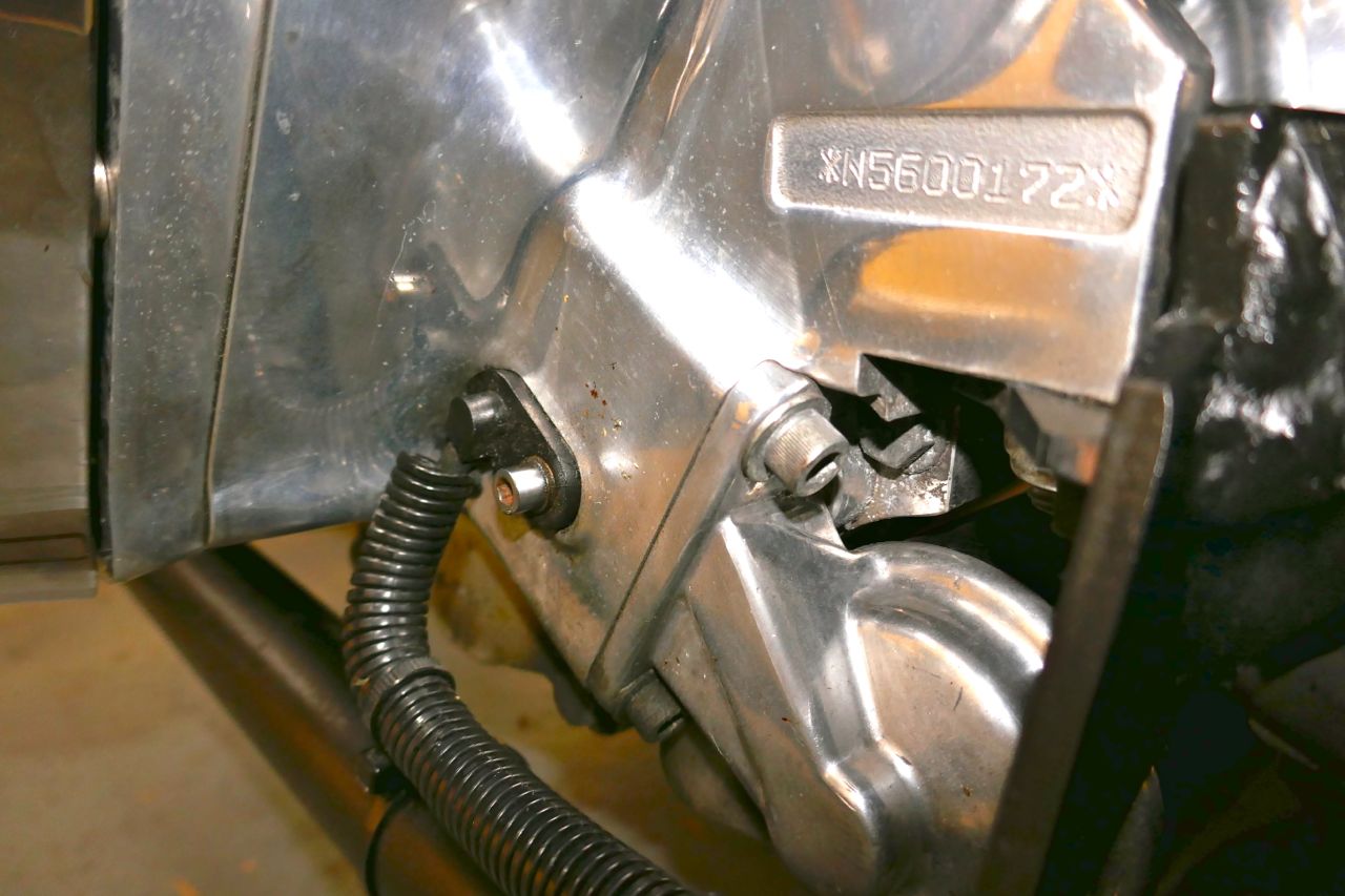

the crankshaft position sensor only deteriorates if the cable is fixed on the chassis instead of being fixed on the engine, I have never had a problem with mine with more than 100,000 km.

Thats a good point. The engine vibrates so much that the shaking would fatigue the cable.

Just undo the hex head screw and slip it out.
