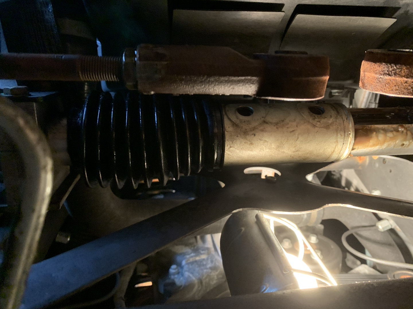

GoMog article here Paul. And a pic I took of mine with OE leaky gaiters.
I think the gaiter on drivers side has to be slid over pinion housing.

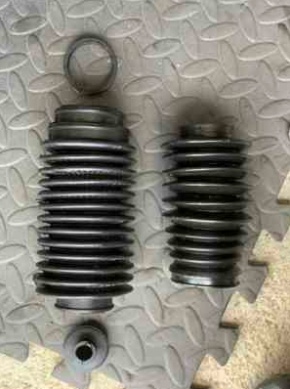

This is the passenger side gaiter (OE) before the universal gaiter was fitted.
Right is split OE gaiter, and left is trimmed universal gaiter. The universal gaiter is slightly longer but is a fraction of the price.

Other possibility is to detach track rods from rack and slide the drivers side gaiter over first then the other. Dealer replaced mine and forgot to ask how it was done. Hopefully someone else will be along to explain easiest way.

It turned out straightforward, Richard.
When the track rods and bracket are removed, the rack sleeve can be slid off and the gaiter pushed on with ease. Both gaiters are fitted from the passenger side as you suggested.

The bracket with the two bolts through it ... is that the same one that also holds the track rod ends?

And how did you open and re-close the lock tabs; the radiator makes access difficult on mine?
