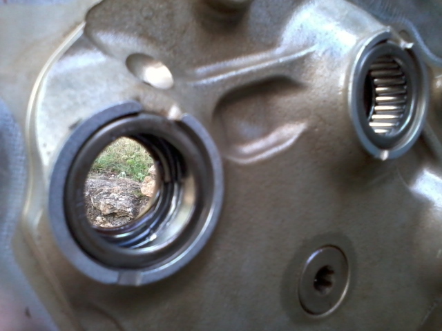

Check the needle bearing of the front exhaust camshaft.
