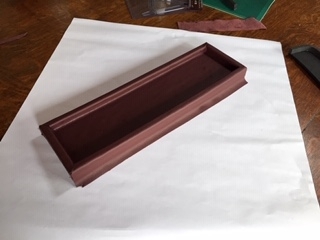

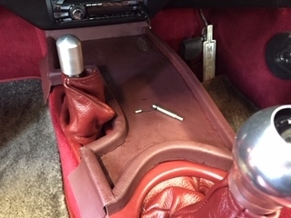

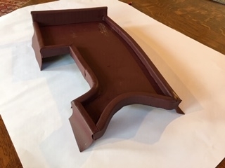

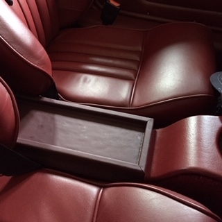

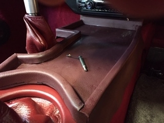

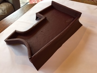

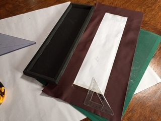

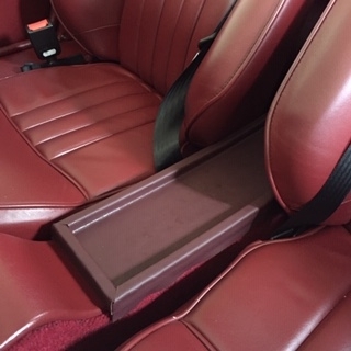

I have had storage envy for some time, particularly related to our phones, sunglasses, USB drives and sweets. I discovered another cubby hole in our Subaru yesterday and decided enough was enough the Morgan was going to get some.

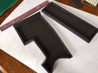

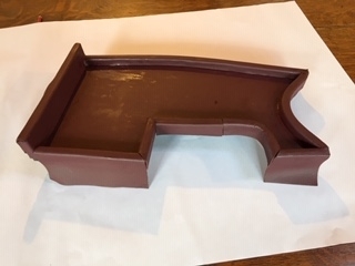

The 4 seater has a fair amount of space along the top of the transmission tunnel that then narrows and continues down between the seats. This is the target area for something shallow to allow access to the handbrake and lipped to keep stuff from sliding off and disappearing into the darkness never to be seen again and so a tray like construction seemed to be the solution.
I made two; one fits between the seats and is narrow stretching back into the rear seat area, it will hold a bottle laid down. The second sits on the transmission tunnel and follows the allowable space around the gear lever and handbrake lever. Both are located by a bit of extra material that hangs down at the sides to stop them sliding about. both will accommodate an iPhone and the front tray will take our iPhone support for ease of viewing the screen when navigating.
I made them from 5mm and 10mm EVA foam boards and a 1/4, 1.2mm thick, goat hide purchased from Pittards. The colour is Mulberry as is the Morgan interior although it is complimentary rather than an accurate match.
Tips for those wishing to do the same or similar:
I would make it from 10mm material all round for additional flatness
Make a simpler outline on the front unit
The hide was too thick to manipulate around the 90 deg angles so I would chose a thinner material - .6mm
Investigate how to make less mess with the glueing - contact cement gets everywhere and got everywhere

Great result. Thanks for sharing.

Brilliant work Kevin and very professional thumbs
If I had more stuff I'd be copying this one.

Well done Kevin, the shaped front one is a good idea
