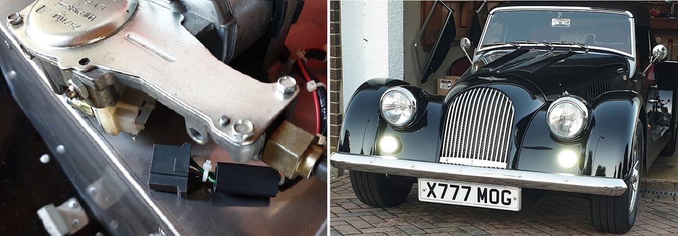

I tapped off the permanent wiper live feed. There appears to be enough capacity to run a couple of super bright 800 Lumen led jobbies as I haven’t popped a fuse so far after 18 months.

Rog, looks very smart. I notice you are using the indicator lights, where do you keep your indicators?

I see from Keith’s post above that it’s called “functional piggybacking”.... The indicators and DRL’s share the same lamp. The bulbs used have some clever integrated electronics to enable the DLR's to remain always on until the indicators are activated and then the bulb changes to flashing orange. When the indicator is cancelled the DRL slowly phases back to white. They are also deactivated when the main lights are switched on as they are too bright for night use.
