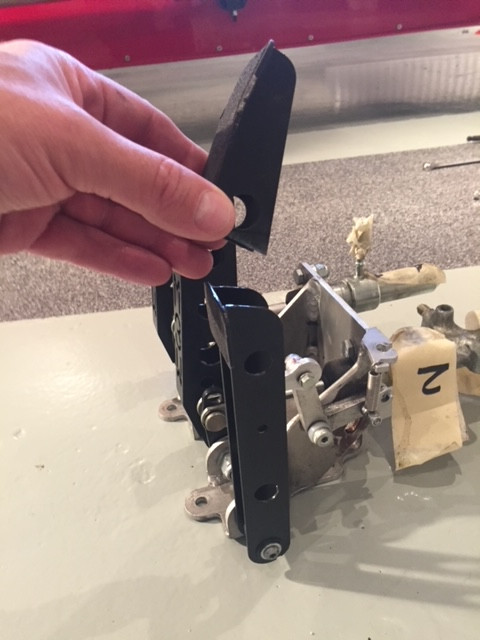

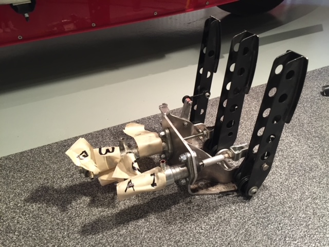

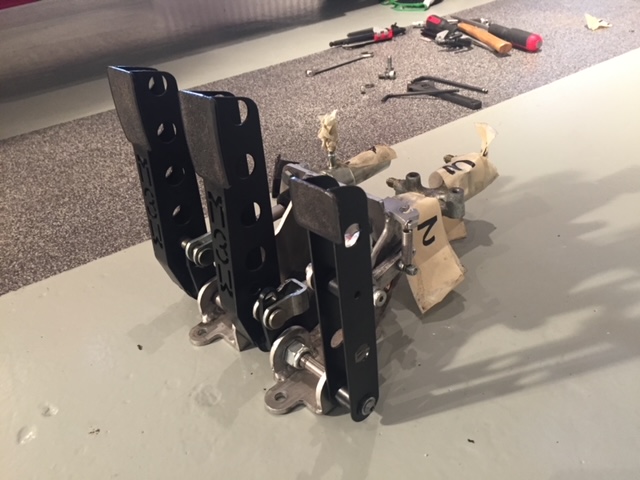

Malcolm. I am 192 cm and I had to make some adjustments to the pedal box.
In the standard setup the pedals are leaning towards you quite a lot. I adjusted them fully to the other direction so they stand up straight. This was possible using the existing adjustment. For the throttle I had to fabricate a new shorter linkage.
I then cut the top of the pedals to stop them hitting the anything when pressed fully down. I have driven it like this since 2013 and it works great for me. You only get 7-10cm extra legroom but that was a big difference especially on longer trips. A smaller steering wheel also helps!

An interesting modification Swedewheeler. Not sure how long ago the photos were taken but I notice that you don't have the brake recall strengthening bracket fitted to the brake linkage, I assume you have now? All pedal boxes with the M3W laser cut pedals (early production cars) should be modified to prevent brake failure if the torque tube weld fails, as has happened. As I expect you are aware, this is an essential modification done free of charge by MMC. It's the only M3W official safety recall.
