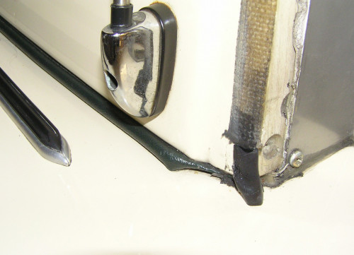

Finally getting round to bolting the wings on (a large swarm of pre-winter chores attacked me and it took a week to fight them off)
Is there any chance someone can take a close up of the piping where it finishes at the front of the car at the bonnet? ...... none of my pre-stripdown pics cover that, so I'm interested in exactly where it terminates and how the end of the covered piping is dealt with.
Many Thanks

Here are a couple of pictures of mine. The piping at the cowl is bent back into itself to produce a chamfer, while the piping at the wing looks as if it was cut to a taper and then any left-over bits covered with heat-shrink tubing. Or maybe that was a previous owner's mod ?

Many Thanks m'Lord ..... that answers a few questions!! 🙂
