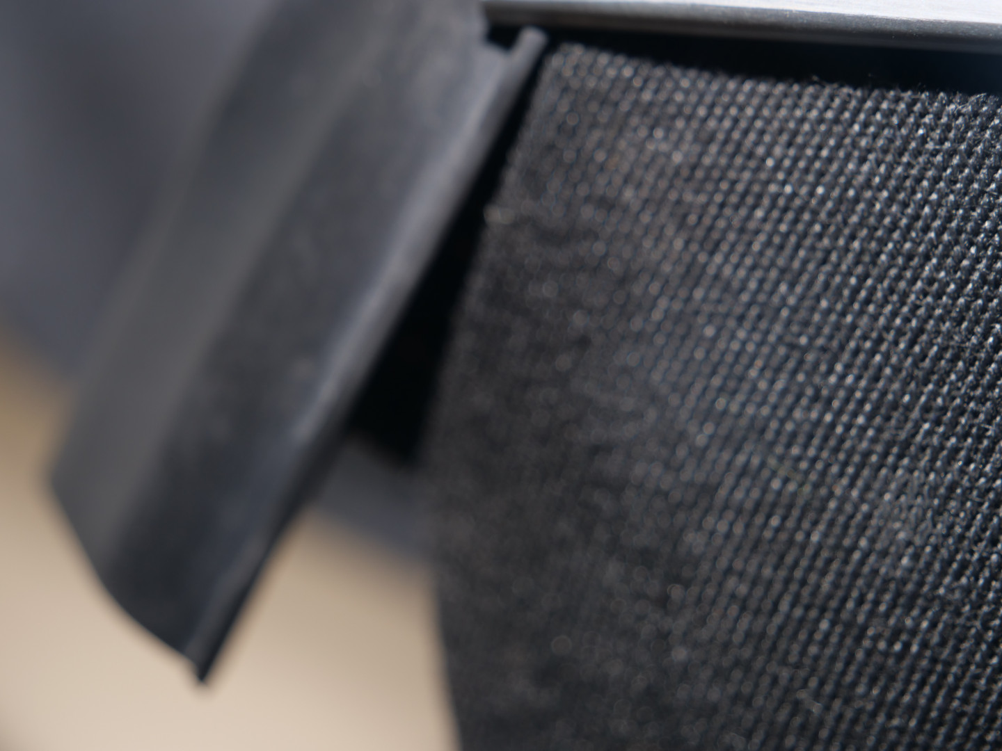

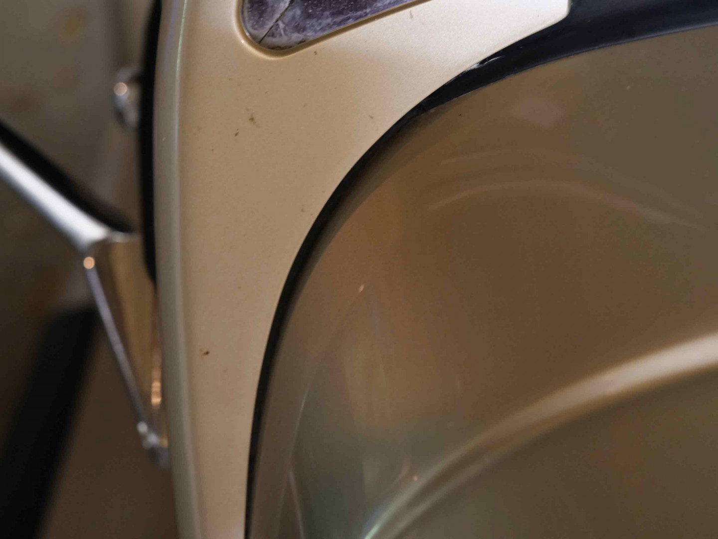

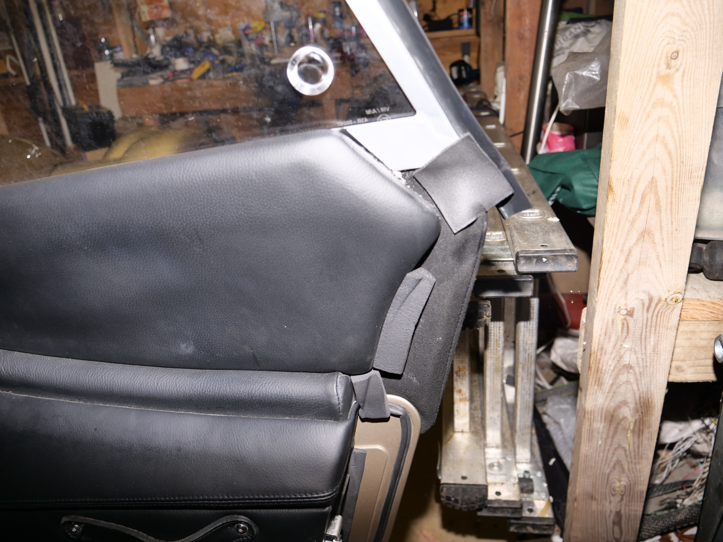

Folks I am attaching a few photos to this postthe one of the windscreen support shows that the MY2021 cars did not have the newer seal around the bottom of the pillar so I inject black "Sikaflex" in the gap - it can just be seen along the top of the scuttle.this stops rain coming in at the bottom of the windscreen.
Also attached is a photo of the back of the drivers door - you can see a piece of neoprene tape at the back of the aluminium piece of the sidescreen- this attaches both to the sidescreen ad also to the rubber strip which protrudes down from the aluminium bit of the sidescreen. this seals off the gap between this strip and the sidescreen when driving as what happens is that rubber strip blows outwards in the slipstream and the gale then enters at the back of the sidescreen!!!the third image is of the rubber strip on the outside for reference. As i said in previous posts I injected foam into the gap beterrn the sidesscreen pad and the sidecscreen itself to seal off the gap between the two
