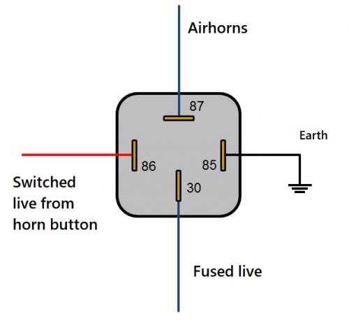

Umm, probably a relay rather than a transformer.
Air horns can take a quite hefty current which would quickly destroy a horn switch.
RobFog #723584 04/11/21 07:21 AM
Joined: Nov 2018
Posts: 6,669
Likes: 434
TBM Offline
Joined: Nov 2018
Posts: 6,669
Likes: 434
Yeah, as Graham says, it looks like an old relay that's lost its cover.
I imagine it will be purple/black to the switch, black to the horns, yellow to 12V live and then an earth somewhere.
New relays are pretty cheap, so I'd just stick a new one in.

Yes agreed any 4 or 5 (ignore 87a) pin 30 amp relay will do the job. I would rewire so the horn push provides a ground connection to relay pin 85. Pins 86 and 30 can then be looped together with permanent fused +ve feed. Finally pin 87 can feed air horn positive with other side of air horns to ground as they probably are already.
