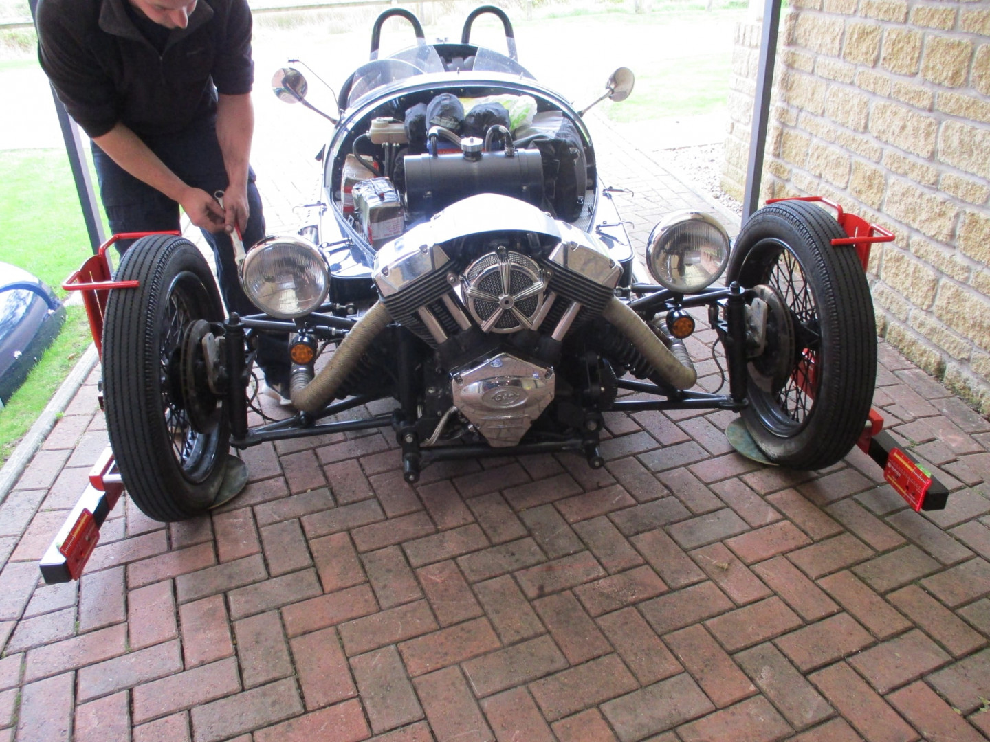

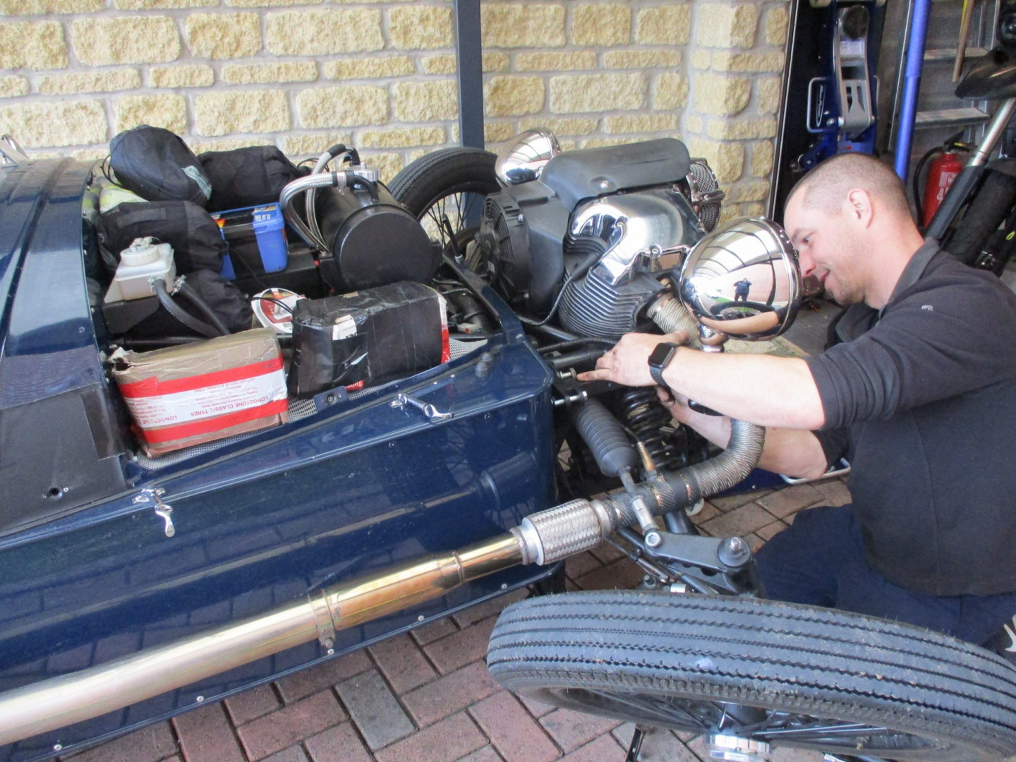

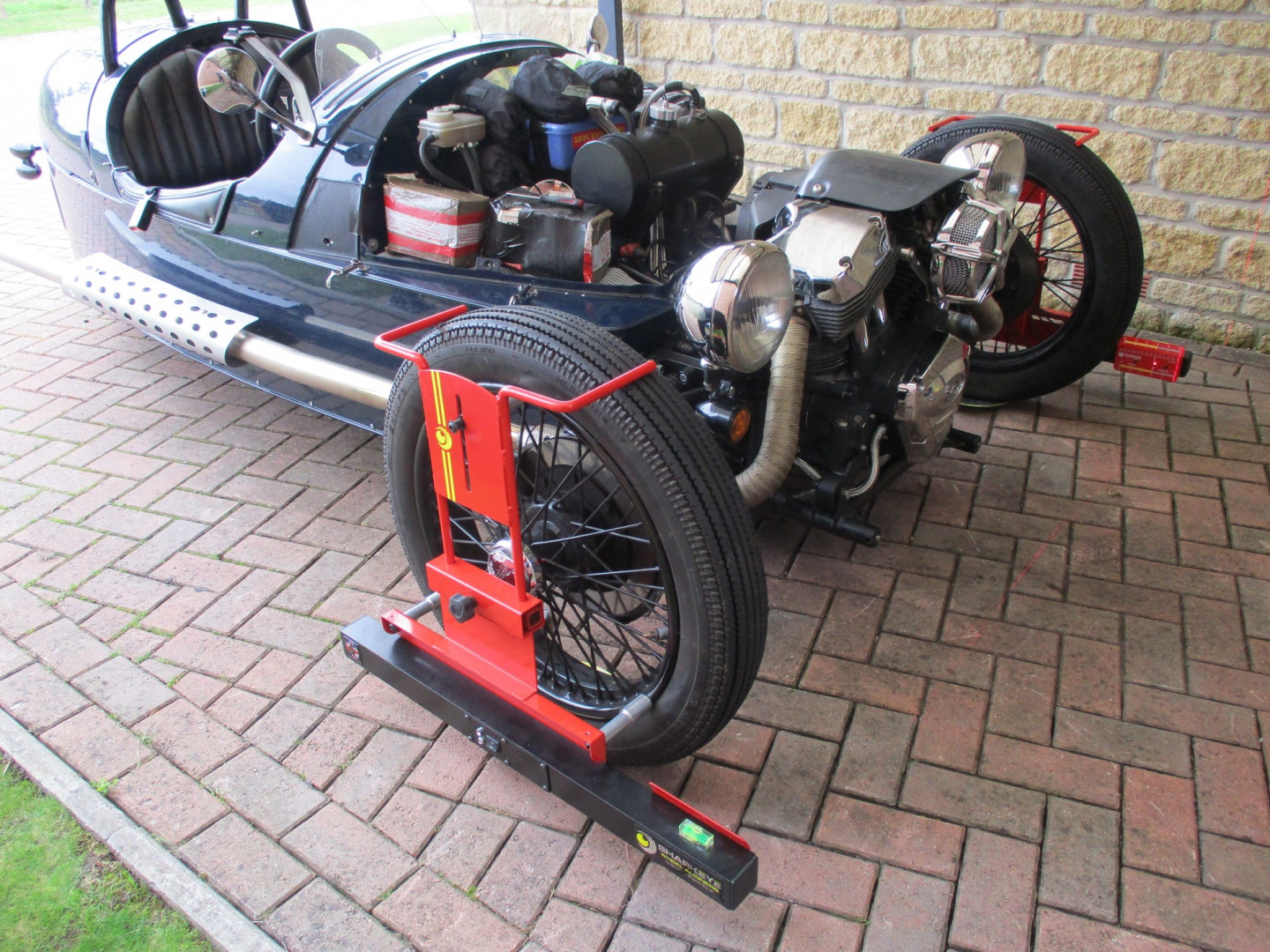

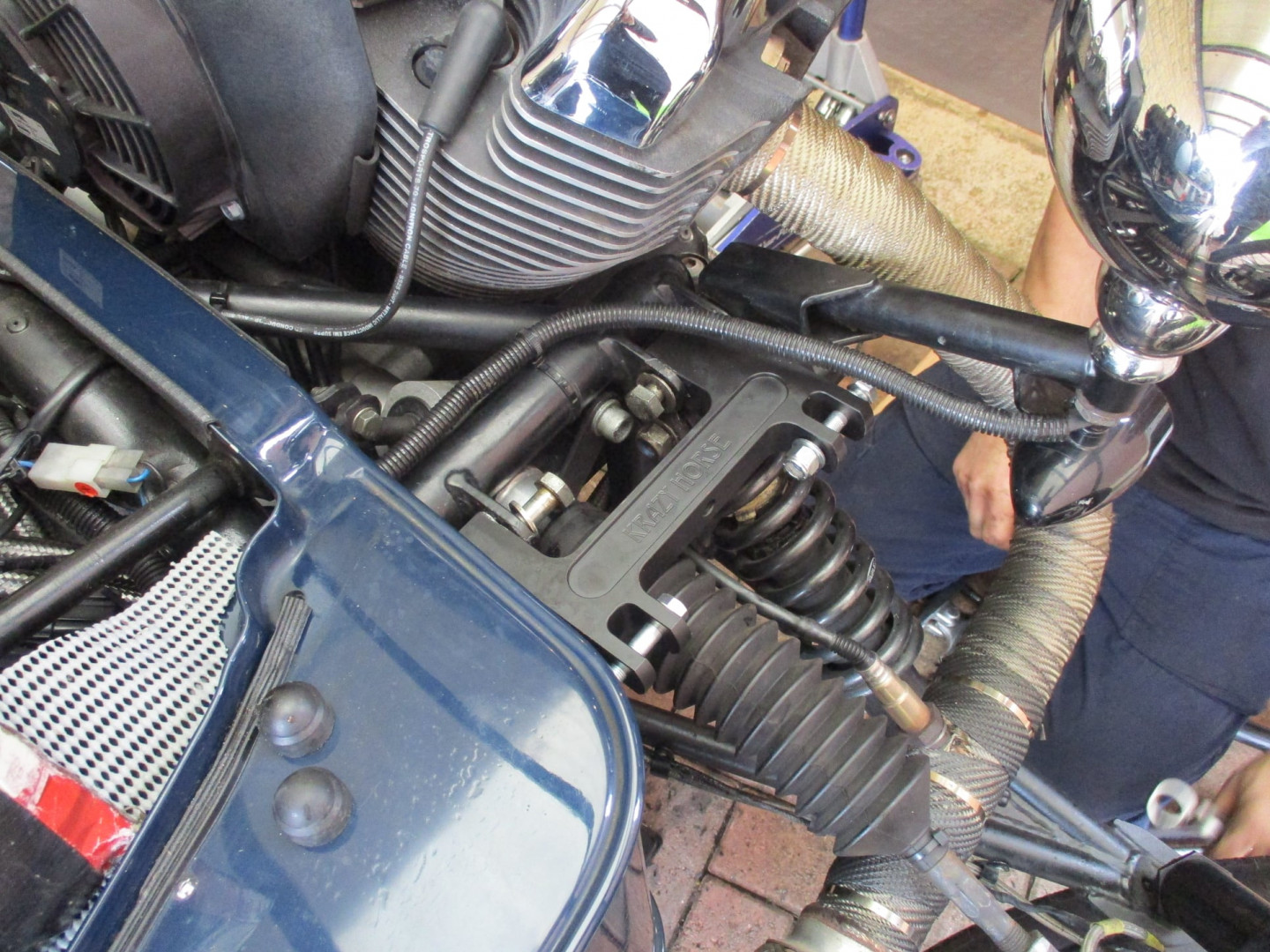

A few pictures of Craig at M3W Services, Swindon fitting my kit whilst I waited ( took about 3 hrs) Whilst I know others have fitted the kit themselves I wanted the castor/camber and toe done by someone with knowledge and the correct equipment. Craig knew what he was doing and it was a pleasure to see the job done so well.
