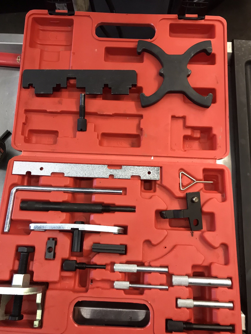

Here is the reasonable prized toolkit from China which did the job well in our case. Original Ford prices could be much higher but I don‘t know. For a ones in ten years job this kit was good enough. It must not withstand a daily job on hundreds of cars.

All you need from this tool kit are these three parts on the upper part of the box. The tool kit is claimed for somewhat diesel engines but the tool also works for petrol engines, it is the same VCT mechanism.
