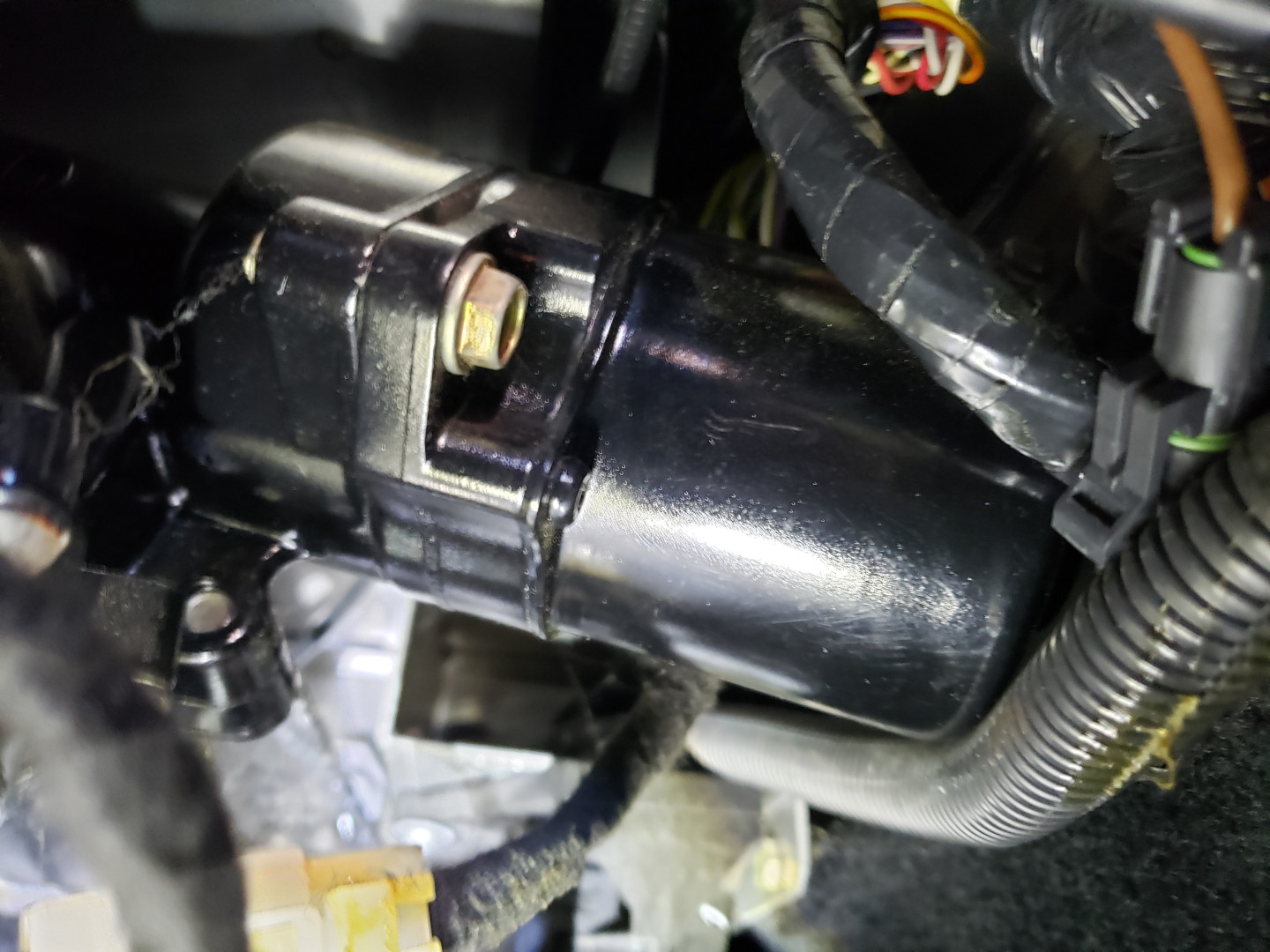

Yes 3 variants. Firstly check you have it. The motor sticks out of the column in the drivers footwell. EZ units should have their name on them. Mine is an MMC copy I think. No markings & the control box above the passengers footwell.

I have an MMC version on my +4, sometimes the large connection plug needs a squeeze as vibration seems to loosen it.

Thank you all - very helpful. No sign of an electronic unit behind the steering column or of an hydraulic one in the engine bay, and the dealer that supplied the car new has no record of ordering or fitting power steering. We are checking further, but it may have been misleadingly advertised.
