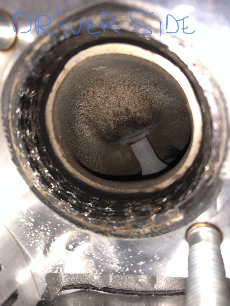

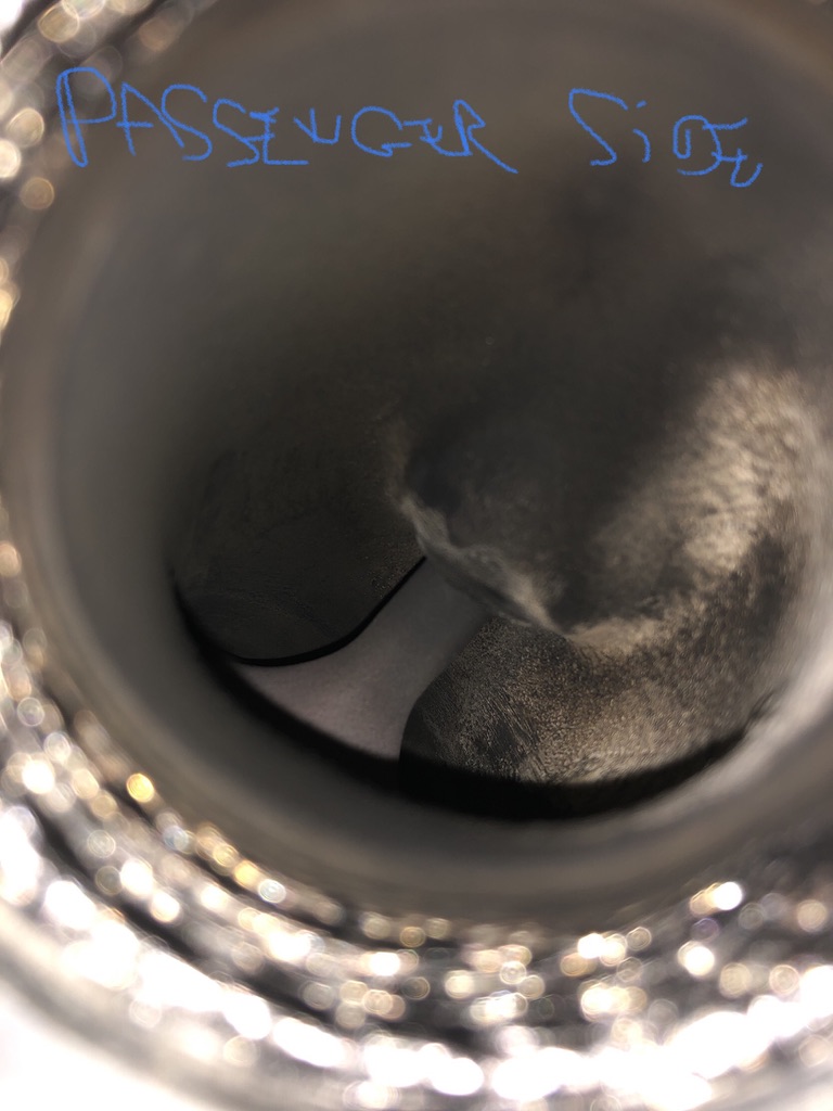

Driver side (USA) front cylinder as labeled by S&S.
Rear cylinder or passenger side.
Looks like a bit of burn difference, not great big difference but it is noticeable.
I believe it has something to do with the angles of the intake manifold and therefore the length of the intake path.
Joined: Feb 2019
Posts: 3,857
Joined: Feb 2019
Posts: 3,857
Just discovered a possible reason for the increase in temperature on the front cylinder, a leaky exhaust valve. The rear cylinder was also leaking but nowhere near as badly as the front cylinder.
