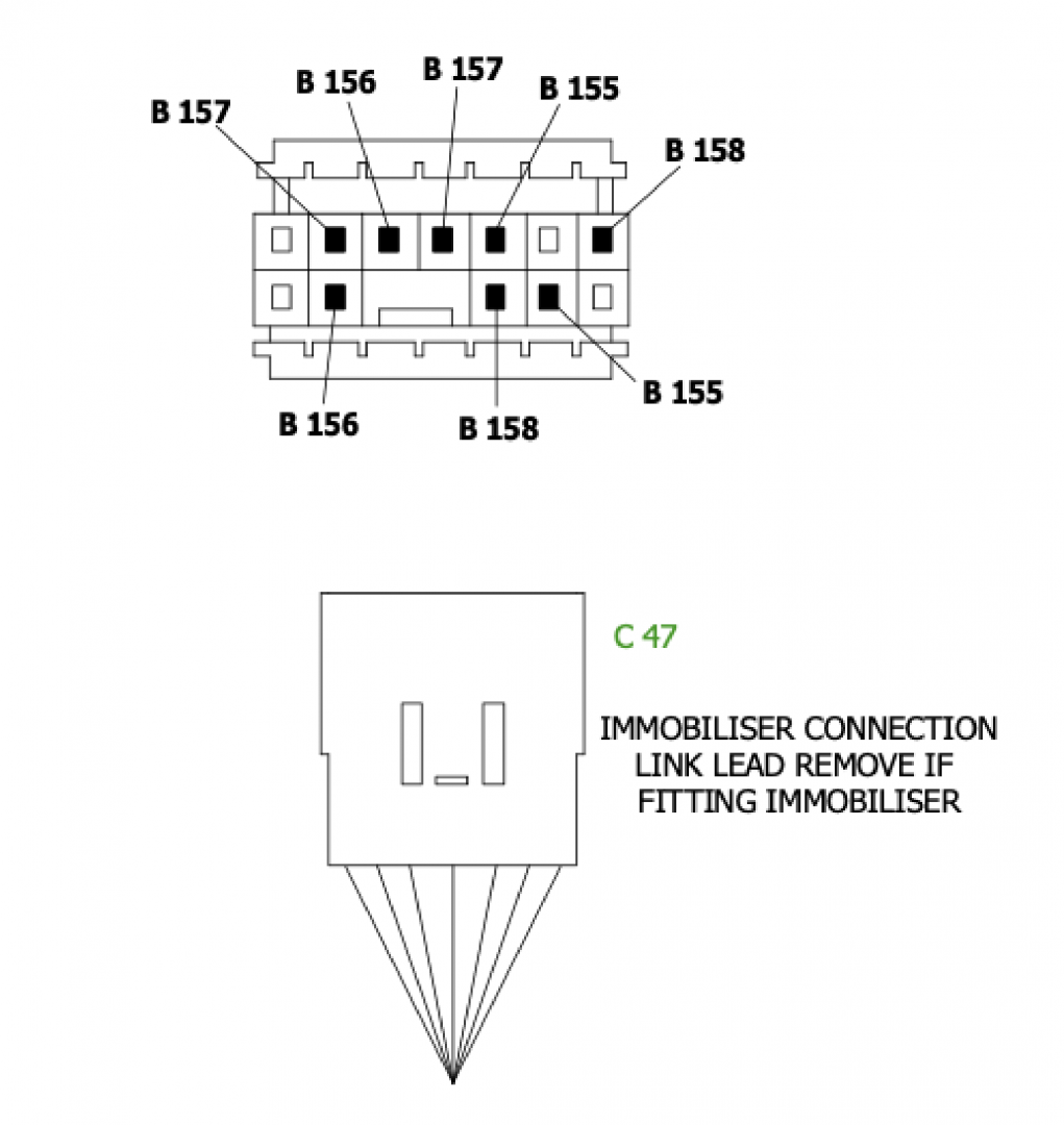

I have bought the connector, but not sure of the pin connection needed on the connector.
The Morgan diagram seems to have all pins shorted together, GLLOQ's has specific pins wired together, is there a definitive answer please?
Thanks

This taken from the M3W Parts Book.
Andy

This is the shorting plug schematic factory fitted when optional immobiliser not spec'd.
As can be seen if provides four loops identified by wires of the same code. These complete each leg of start circuit and coil circuit which presumably the immobiliser (when fitted) inhibits until cancelled by fob.
If you look carefully at the last image GLLOQ posted, the above not surprisingly, ties in perfectly.
ETA: Andy beat me too it wink

Many thanks Andy , Richard.
Spot on.
