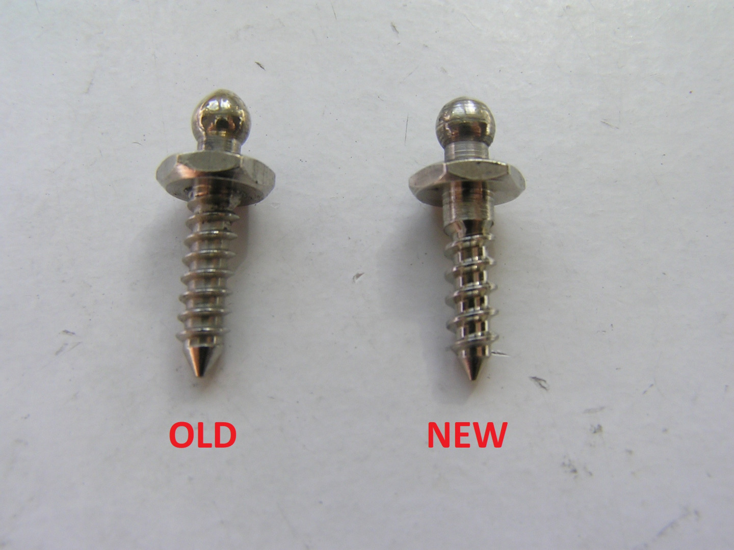

If you have a mohair hood, do not throw away the old fastener beefore you fit a new one. I went to my local supplier the old one, bought a new and left the old one as scrap. When I got home and tried to fit the new Tenax after a fortnight, I discovered that the threads on the male part screwed on from the inside was a couple of mm shorter. I just could not make them to enter the female part, the mohair fabric being rather thick. So I went into a deep depression, foreseeing an eternal hunt for another Tenax with longer threads, and perhaps not finding it....
A telephone to the supplier revealed that for some reason he had not thrown away the broken Tenax that I left, so I went over and picked it up. So now the Tenax is back on, new male part combined with the old female part. But it was a near miss. Small part, possibly big problem.
P.S. With an Everflex, I do not think this would be an issue.

Originally Posted by Neilda
....it's meant that the Tenax fasteners no longer clip into place with a click. Net result, they blow off when driving along - these are the 'hood tidy' Tenax that secure the side flap things - if you see what I mean.
I have just bought a couple of the (male) parts of the Tenax fastener from a reputable supplier. I want to add them to the hood frame to stop the annoying flappy/rattly tendency when its folded down. I removed the part fitted to the body above the door, in case they had worn and I would replace them with the new ones. Possibly of no real consequence, but the new ones are very slightly different from the factory-fitted ones. Just for the record, the new ones are the same overall size and have an 8mm flange/nut, but have a coarser thread (they are the screw-in type), and are not threaded all the way to the top. And beware there is also a "similar" fastener available called Tomax, which seems a bit like passing-off to me.
