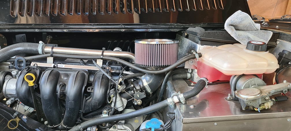

The Plus 4 GDI setup (from outside towards engine) is this:
- intake hose
- intake airbox with airfilter
- MAF sensor
- silicone hose
- throttle body
- intake manifold
Thus my question; right now the MAF sensor is directly attached to the airbox, a "redesign" with MAF sensor and airfilter directly on top of the throttle body would certainly increase vibration...

Alright, I feel adventurous:
Short silicone hose on top of throttle body, then MAF sensor, then air filter (smaller K&N on the way)
So much space now on this side of the engine!
Some weight reduction with all this stuff gone wink

Nice work Robert thumbs
That looks a little different now. Does it work ok with GDI engine?
