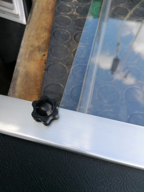

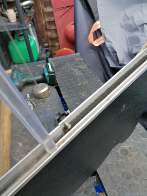

I drilled & tapped the lower aluminium channels in the sides screen to take flat head knurled screws, this stopped the rattles and provides some additional security when parked with the hood up.
That's a very good idea! Land Rovers had something similar with their S3 Military Door tops. Mine are very loose and slide open, so will be doing something like this over the weekend.
Job done

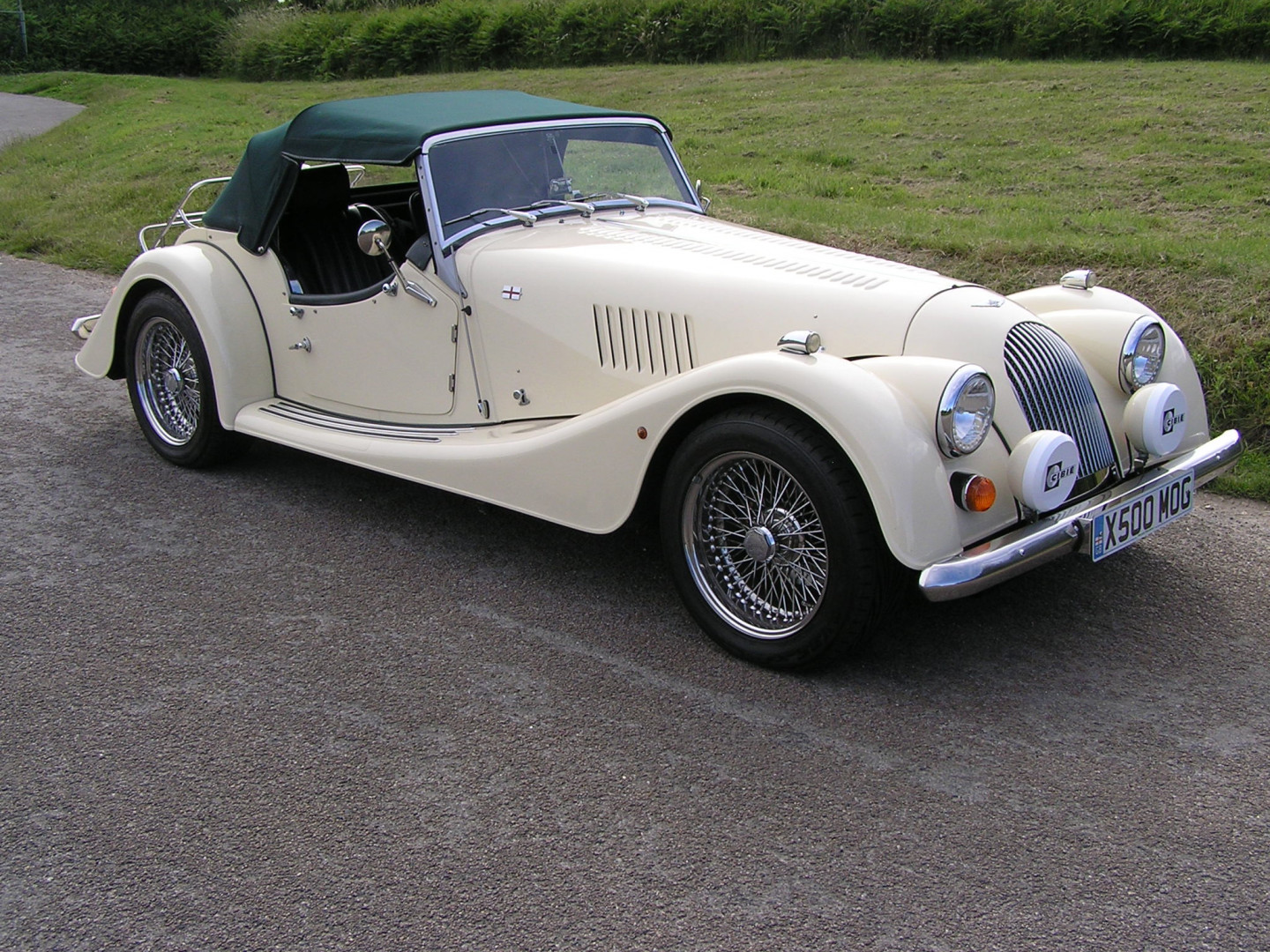

Originally Posted by Quicksilver
A nice looking compromise is to drive side screens off but hood on. It looks quite rakish but the hood billows a lot at speed.
A bit like this.... great for when Autumn comes along (after all, the evenings are drawing-in now....)
Yes - a great look.
