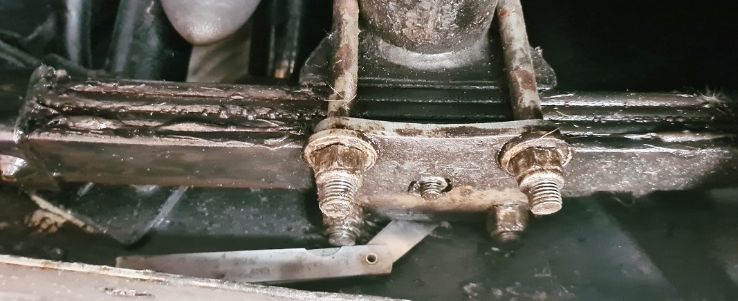

Just a crazy thought but are those new u-bolt plates/saddle plates rubbing the inside of the vertical chassis on the off side? Can you slide a piece of card or something up to see if you have clearance? My u-bolt plates are within a whisker of the chassis on my offside. Loads of room on the other side.

And also if the u bolt ends are touching the chassis it will prevent full expansion of the spring. Another paper test at full rebound.

I'll check all that tomorrow (Saturday) I am pretty sanguine there was room between u bolt threads and the verts.

This gap…. ![[Linked Image]](https://dl.dropboxusercontent.com/s/jri8w6fc0c763hf/spring%20gap.jpg) If my two outer u-bolts had washers like the inner pair then mine would rub. There is also a protruding bobbly weld a at the top of the vertical chassis return that something could potentially make contact with.

My friend and were hard at it this last weekend, well saturday, wife stopped play Sunday. We reset the SSL to make sure it was set correctly, the way Peter Ballard told me how to do it. We took measurements, floor to chassis etc. all round, we believe the (assuming floor approx. level) that the chassis is 10 mm lower N/S. no apparent damage, twists, cracking evident. We then moved on to the shackles to make sure there was nothing amiss there, loosened them, they seem to move when bounced, that was easier to see when someone else was helping. My friend then looked at the U bolts to check I was correct and that they were not touching the chassis rail they were not. plenty of room. We then checked they were situated correctly i.e. they were sat in the centring hole in the axle by loosening the U bolts and checking, they are. We ran out of time, so fully intend to remove them this coming weekend and swap them over. This will hopefully, tell us if we have a faulty spring. It could be that the body naturally leans that way however I believe as you do, that the axle resting on one bump stop is the issue that needs addressing.
