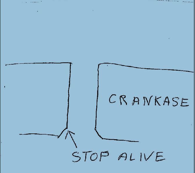

The impedance of the sensor is 1030 ohms, I have just dissected a bad model S&S sensor to try to transform it xwedge, my backup sensor is an xwedge sensor which had the cable cut which I repaired by attaching a Deutch directly to it with gold plated connector and made an extension cable always with gold lugs and has been tested for a few hundred kilometers without problems
I am going to lengthen the new modified sensor with a tube that has a mounting bracket for the screw.

I got to my end by extending the sensor and spending the afternoon there, I could have reused the sensor cable because it was long enough.
I had thought of buying Bitcoins to get rich I didn't, I should have bought crankshaft sensors.

It is good to soften the sharp edge at the entrance of the sensor. I have already noticed when dismantling that the O-ring was damaged and that to put a new sensor back in, you have to focus considerably.
