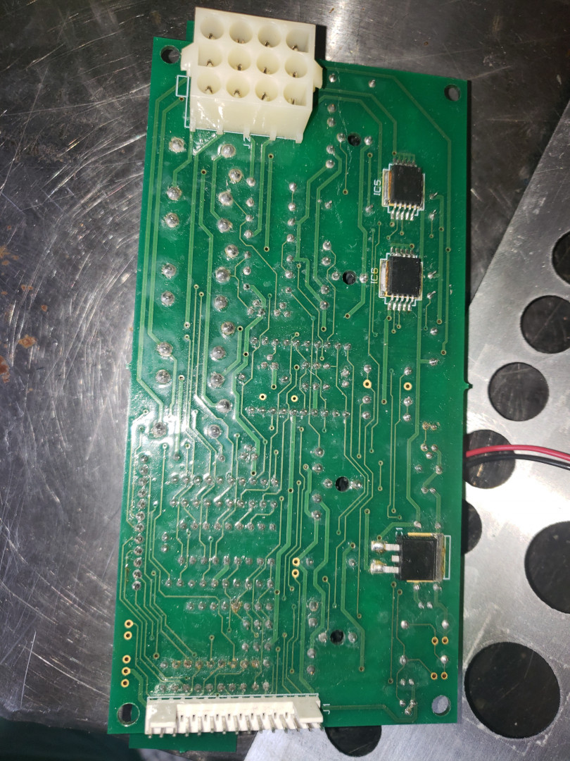

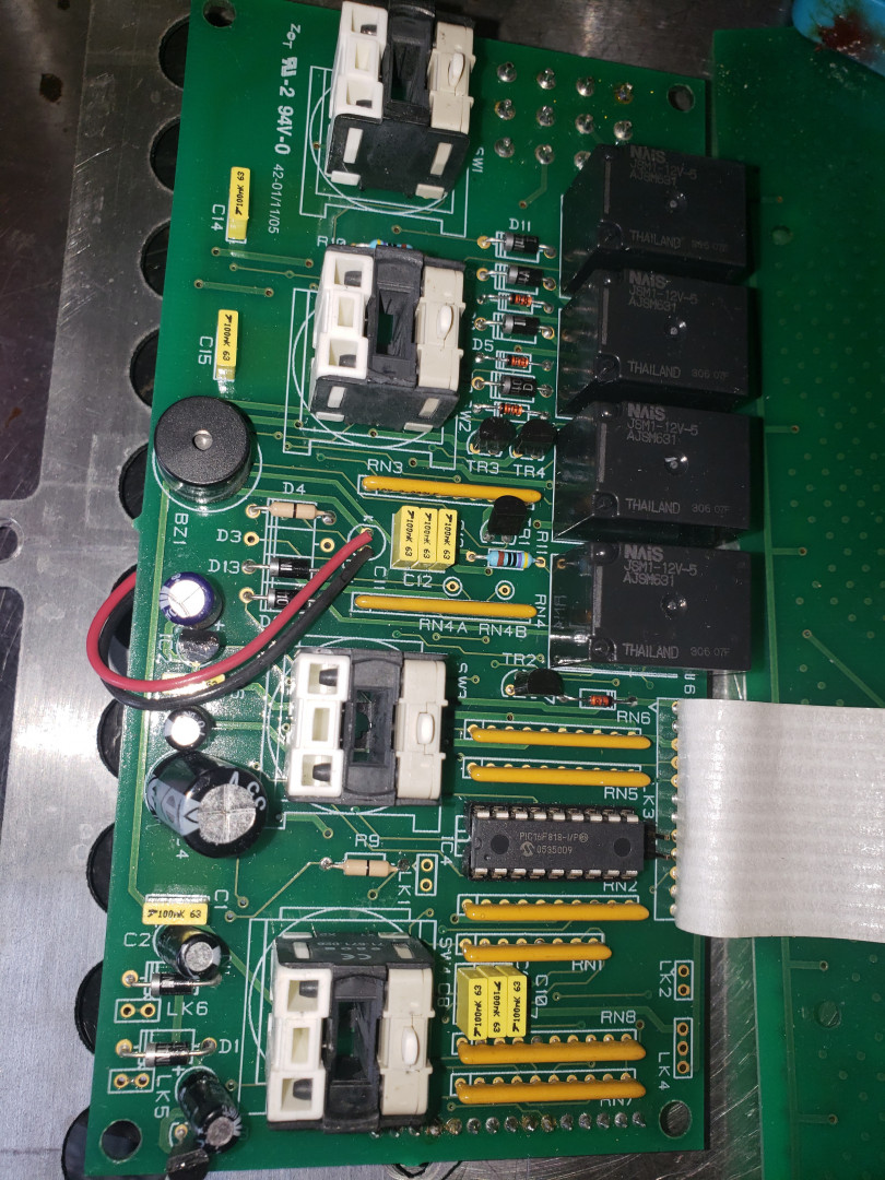

Thanks Leroy so you do have the sequential momentary switch control. The fact that slow is after fast has no great bearing.
The relays in your top pic have no relevance to heater fan control as mentioned above. It does seem that the likely culprit is the PCB though which provides the switch controlled logic to (I'm guessing) two miniature soldered in onboard relays. One to control power feeding to another to control speed. If it is a relay problem on this board it's likely the latter.
You could work back from motor itself checking power with the cable colour codes I gave above, but I expect you will find power on fast cable when fan is running but not on slow cable when selected.
Given scarcity and cost of new PCB added to difficulty of working on existing, it may be the best option to leave as is.

Leroy,
photos of the PCB. I suggest you try the lights on off trick to see if that works. If you find it is the switch that is faulty not the PCB I have a spare off my old PCB

Thanks for posting the pic’s John. So it’s looking like there might be a single and dual speed board. With the second relay (next to the 12 pin connector) missing on the single speed configuration.
Leroy from your second picture it looks like if you were to take another pic maybe with a bit more light from the flash you might be able to just see if the relay is there or not? Or if you could lay on your back and poke around with a suitable bent plastic probe you might be able to feel if that second relay was in place? I believe some early Roadsters only had one speed....

I'll give that a go Rog. Yours and John's pics are useful to understand what's going on, and what I might have. I definitely had two speeds not so long ago, but as I don't use them often I can't pin point when it stopped working. As I'm clearly getting power towards the motor from the slow speed setting, would that mean all is good PCB/RELAY wise?

I have the same 4 relays as John has above.
