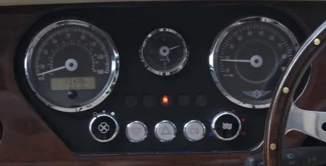

As it stands with no markers on the knobs for all I know the fan may have more speeds than two, and as I've already said the number of heater settings remains a mystery to me too. However, by the look of these images I took from an advert selling a 2016 Plus 4 it seems MMC too it upon themselves to add some control knob markers on the last direct injection engine equiped cars.
If my 2012 Plus 4 has the same number of settings as the later car the above images seem to indicate I do indeed have two fan speeds, but I may actually have a whopping five heat levels to choose from!!!!!
Perhaps someone with a 2012 Plus 4 like mine could help clear this up for me?
