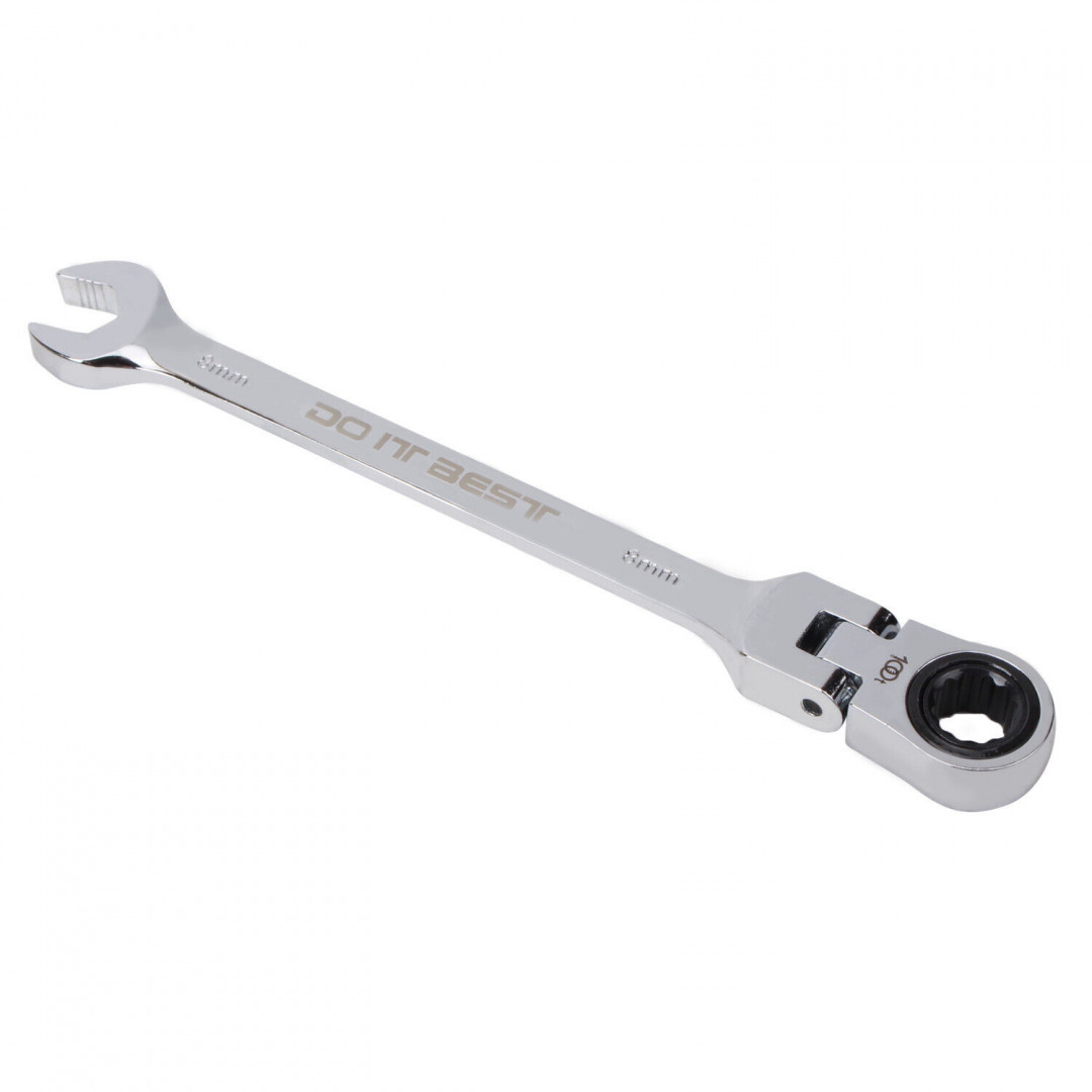

If Pauls tip helps, perhaps a ratchet wrench like this may help to save some time?
I often use it with a piece of adhesive tape on one side to avoid screw heads or bits slipping through.
