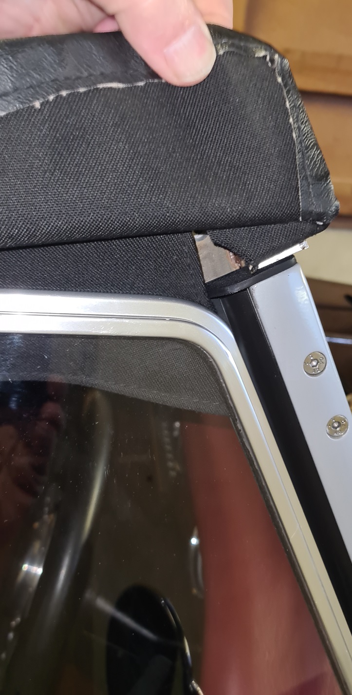

And another!
Early days but it looks fine so far.

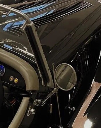

Richard, Any chance Of a picture as to how you fitted the bottom end of the seal into the curved section of the A pillar.
Regards, Martin.

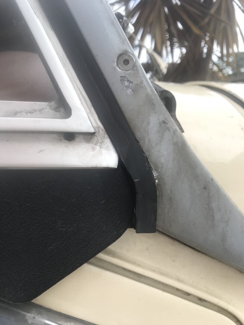

Originally Posted by sewin
Any chance of a picture as to how you fitted the bottom end of the seal into the curved section of the A pillar.
Maybe these will help. The first two pics are cropped from online images. The third is my car when I replaced the seals.
The new seals will probly be 1cm or so overlength. So I did mine by trimming the inner face of the bottom of the seal first, following the curve of the pillar. Then trimmed the outer face straight across at the point where the curvature starts. Finally, when you have the new seal in place, trim the top end to fit. (It's easier than that description might sound). Maybe another TM'er has a better close-up from their car ?

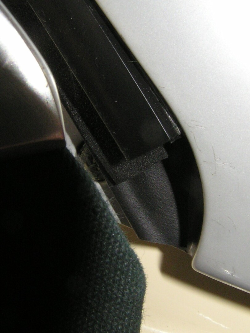

I did mine a few years ago.
[url=[Linked Image]]Base[/url
Fwd part of side screen tucks in nicely, but you do have to cut the blade part of the seal to allow the bend.

Thanks chaps!
Like the way you've tackled them. Factory fit isn't as nice as that and you have solved the question I had about cutting the corner spine to enable the outer facing seal to protect into the door shut and fitting the radius to the inner face. If they were longer I'd happily got the scissors out but they're only just overlength so I thought I'd ask and see how others fared! I had also wondered if the sticky tape would hold around the radius as its quite a thick and short section ending at that radius too.
That's surely got to keep the wet at bay! Much appreciated!
