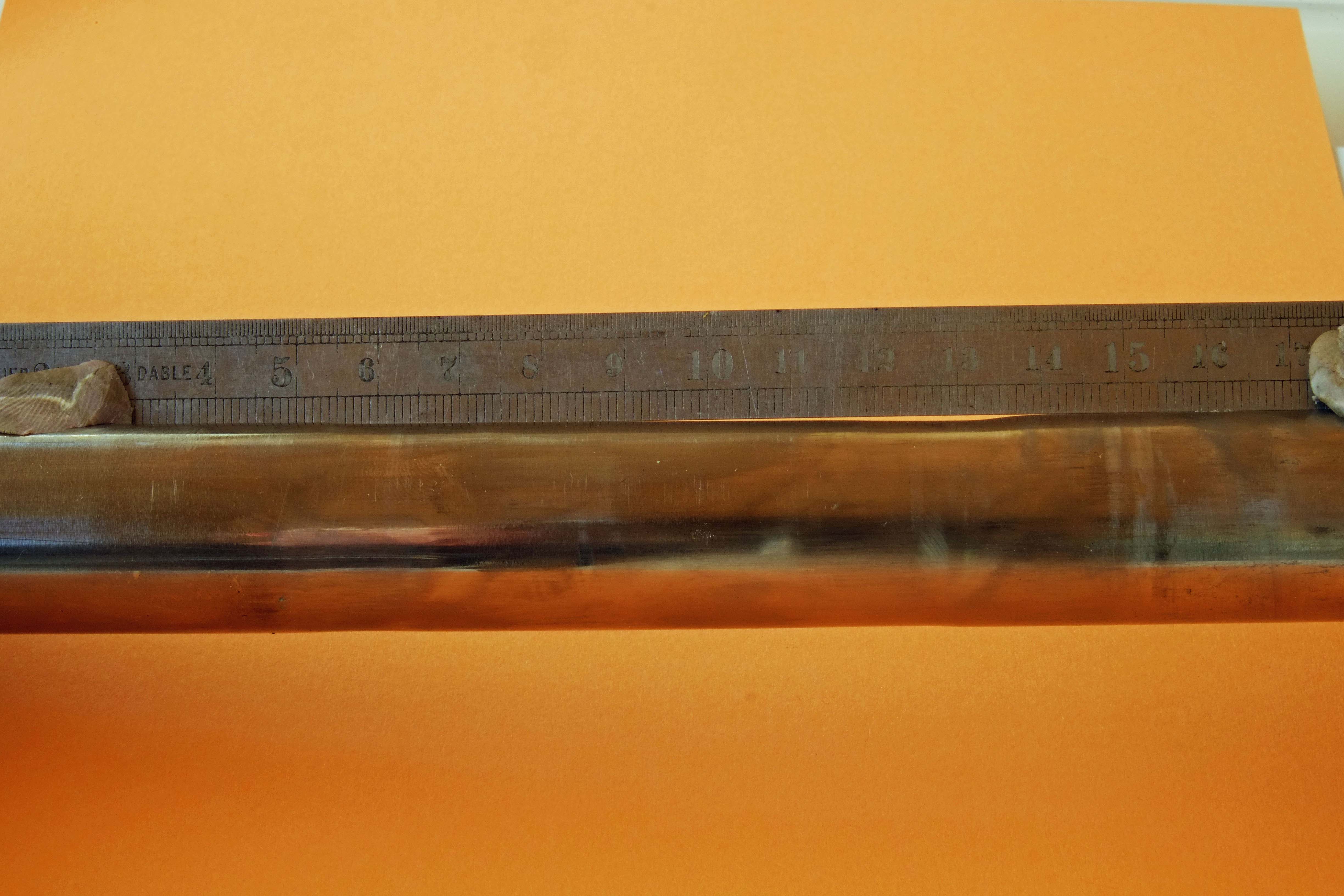

An exemple of kingpin wear with Devol bushes. 37000 miles, greased every 750 miles from 9900 miles (second hand car).
Replaced with hard chrome kingpin, spiral groove phosphor bronze bushes and SSL KIT.

Barely worn compared to mine laugh2

That's impressive wear.
