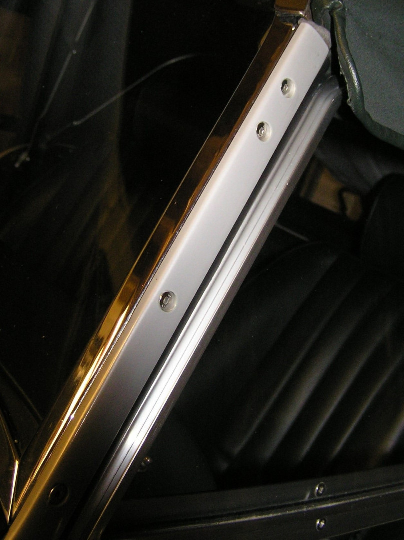

Just a note to say that fitting these seals may not be straight foreword. I did mine a few years ago. Prior to purchasing I did some measurements which lead the supplier to believe they would not fit. However I then went and took some pictures of the fitment on new cars. Basically the fit of the side screens were so awful they did not fit to the new cars either.
Anyway I bought some and did some fettling of the side screens, to get them parallel to the w/screen pillars and the right distance. I elected to stick the new ones over the old to get a better seal with my hard top fitted. They have proved to be really good, even keeping the side screens snug even at speeds on track 100mph + Adjusting the side screens is a “pita” in my case on one side had to elongate the screw holes where the metal mounts join the side screen. (Imho one of the new cars the alignment was so far out I doubt it would have been possible) see pic.
