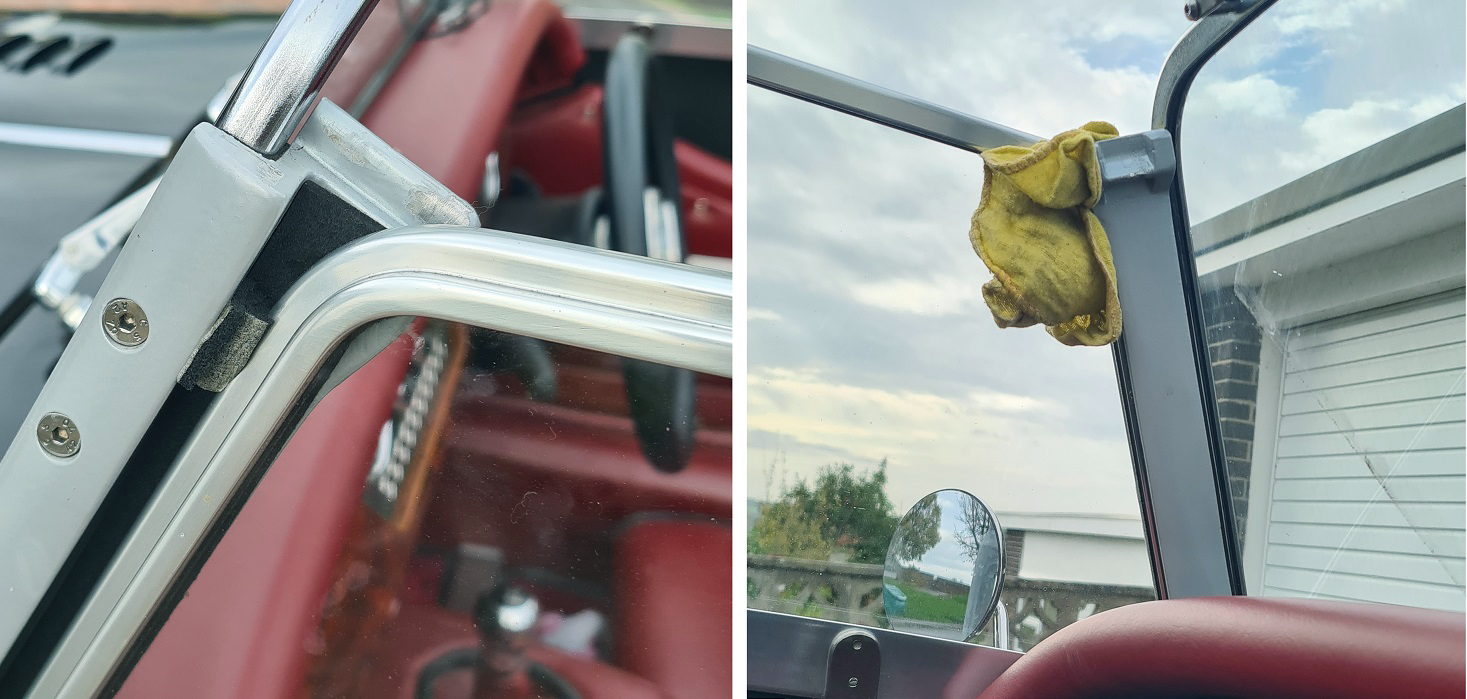

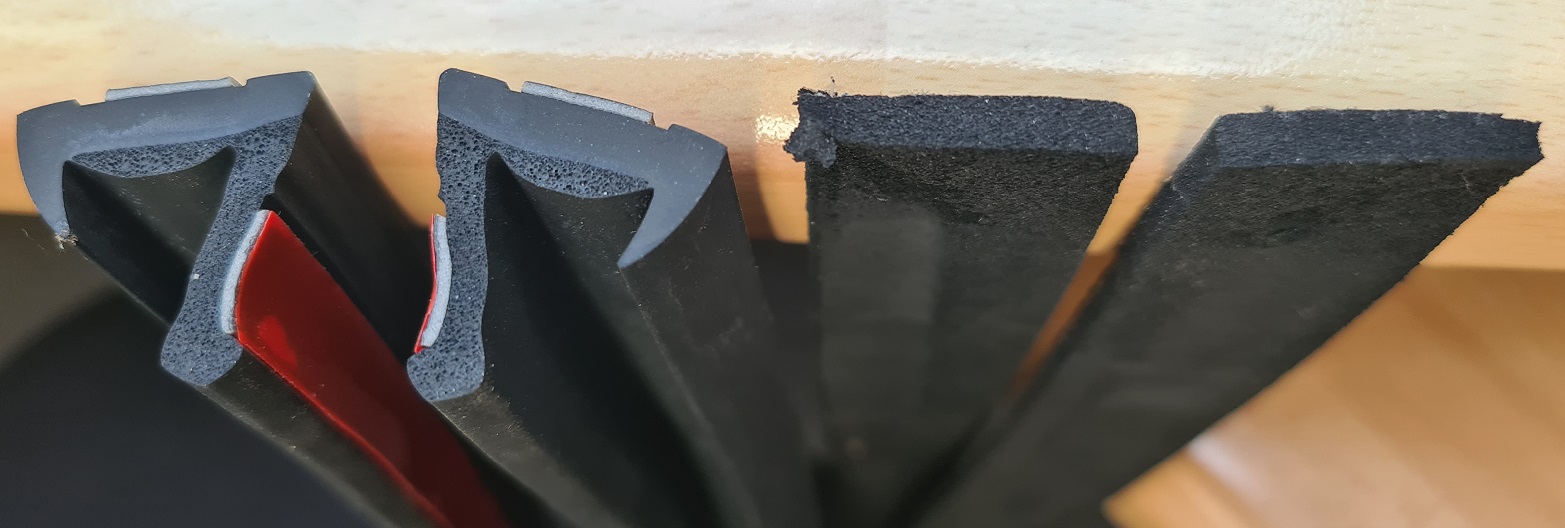

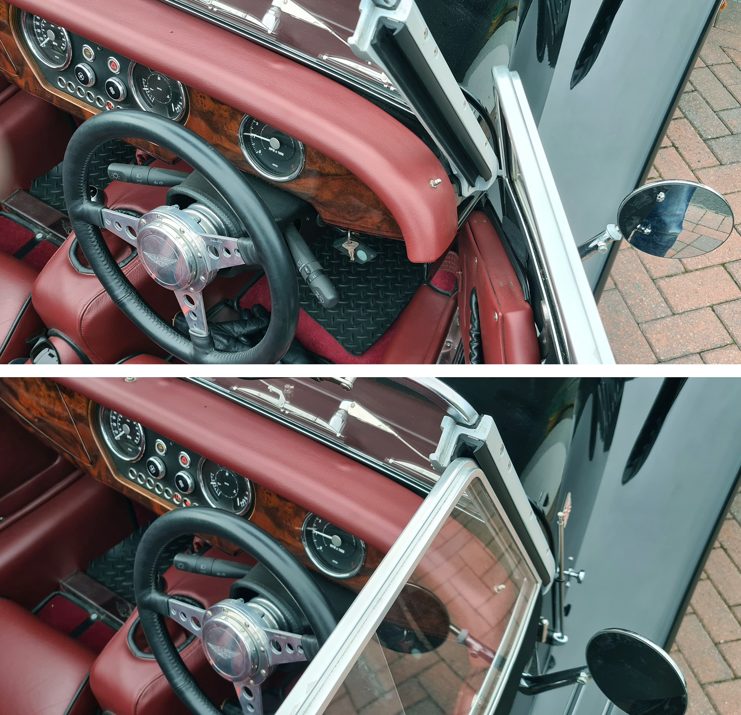

What a difference! I should have upgraded to these later pillar seals ages ago banghead
They retain the screens beautifully, a massive improvement to the original sticky foam strips on earlier cars.
I’ve tried all sorts of tricks in the past to silence the tiresome din that my sprung loaded unrestrained screens make as they thump the pillars over bumpy road surfaces.
From strategically placed bits of neoprene to stuffing a duster in the door out desperation on a journey crazy2
New and original seals.

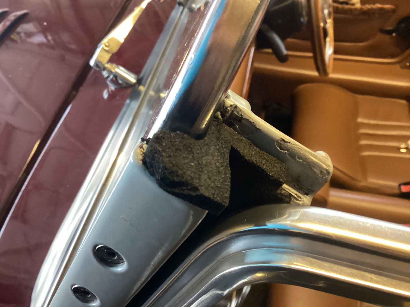

What…no foam/neoprene seals on the very top of the A-pillars? Have you driven it in the rain like that, with hood up?

Anyway, without that bit of neoprene I would get water running down the a pillars.
Incidentally, seals like this were at these points when I collected the car from new but I have had to replace a couple of times over the years. Strange others don’t have them…maybe mine were installed as an extra feature during pdi tests!?

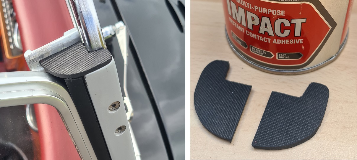

Thanks Doug and well done with the pic thumbs
Job done but I only had some EPDM sheet.
