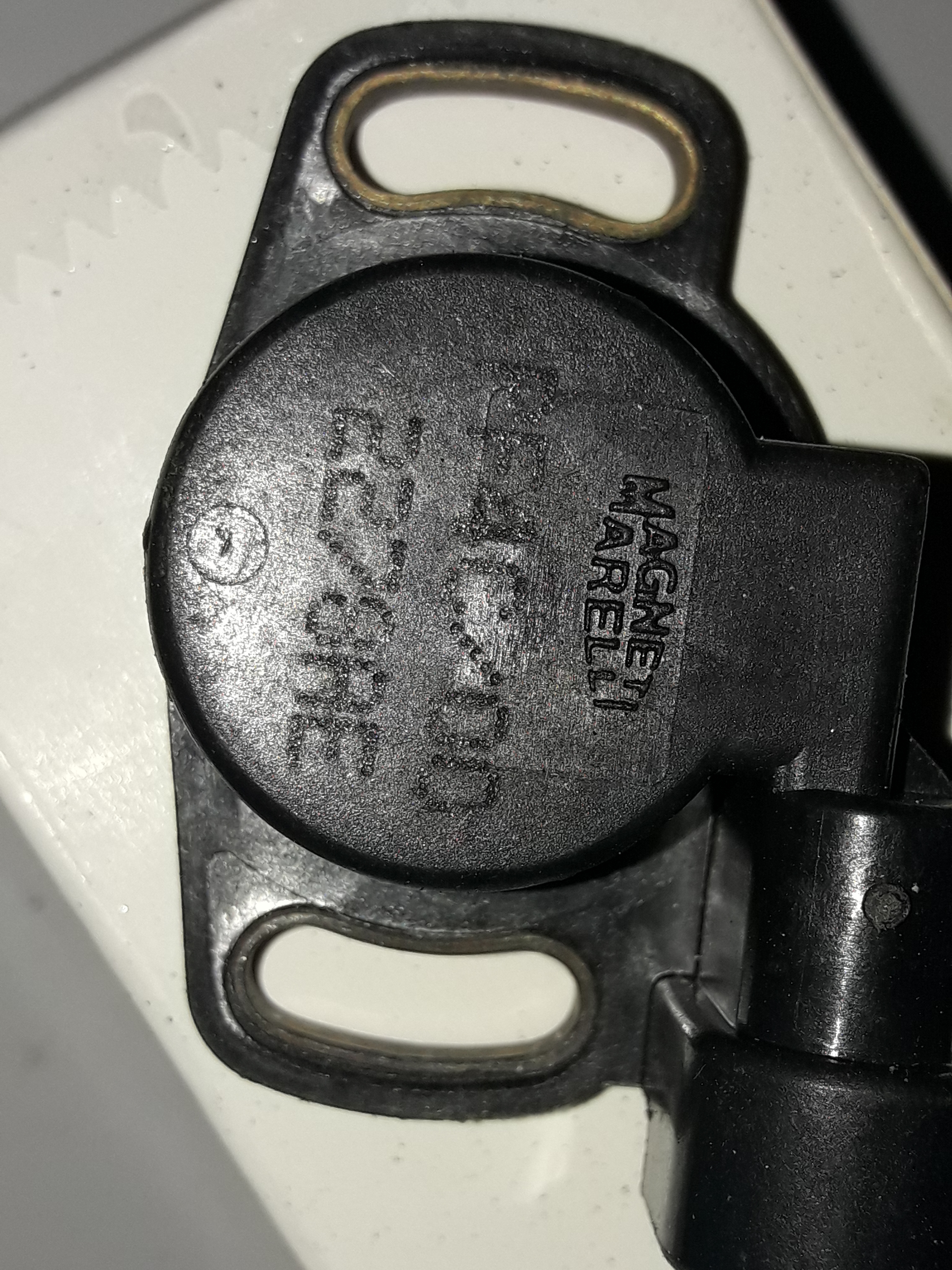

Joined: Nov 2013
Posts: 786
Likes: 18
Joined: Nov 2013
Posts: 786
Likes: 18
I received a replacement sensor from China.
