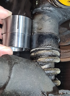

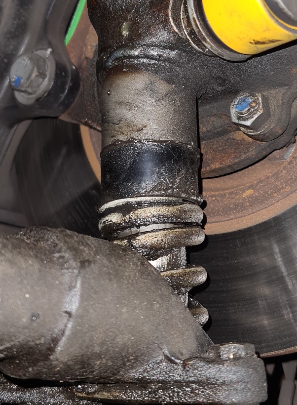

I had also planned to give these PTFE wipers a whirl. They attach to the lower stub tubes above the bottom spring in an attempt to keep the muck out.
One day perhaps….

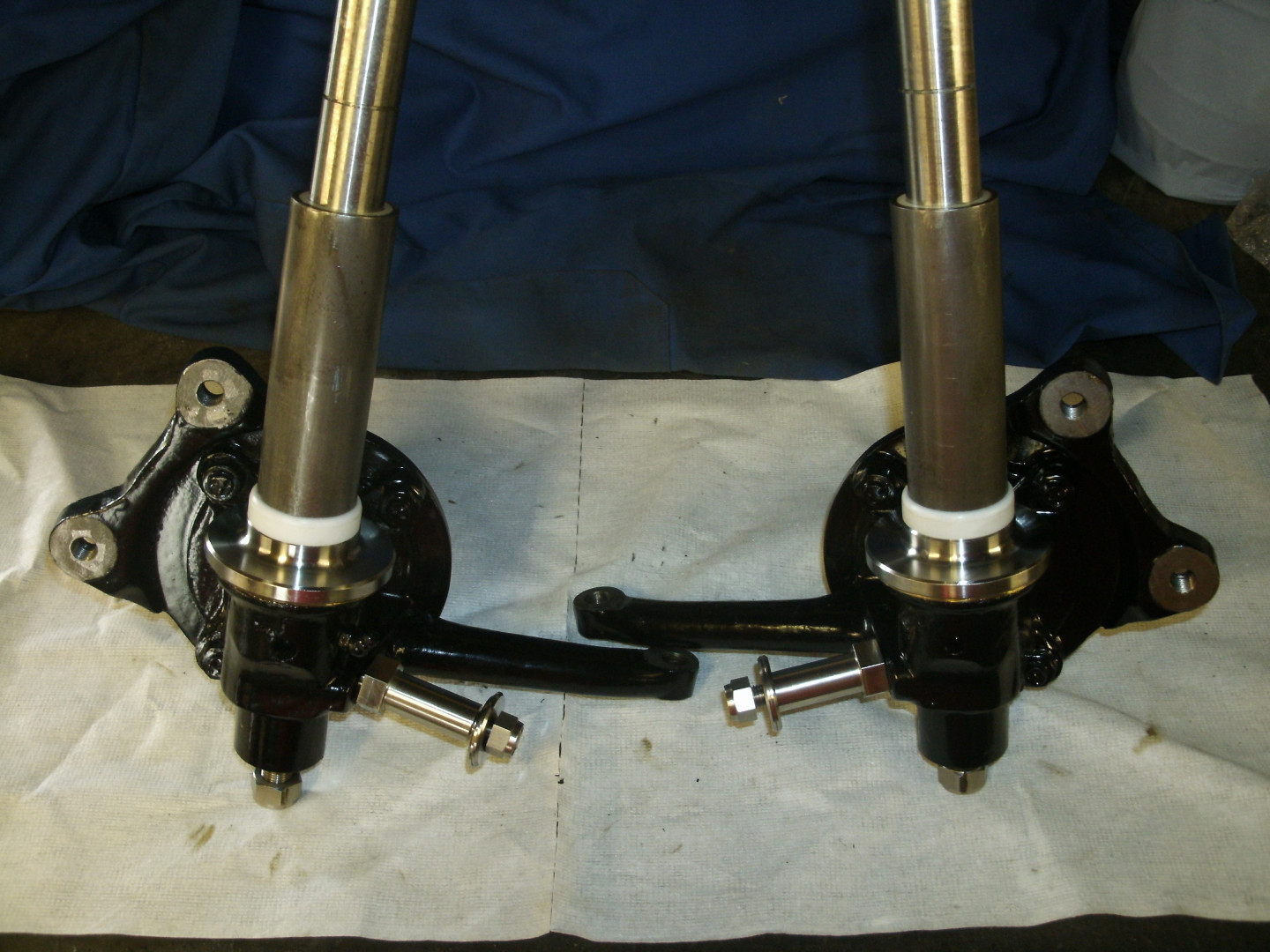

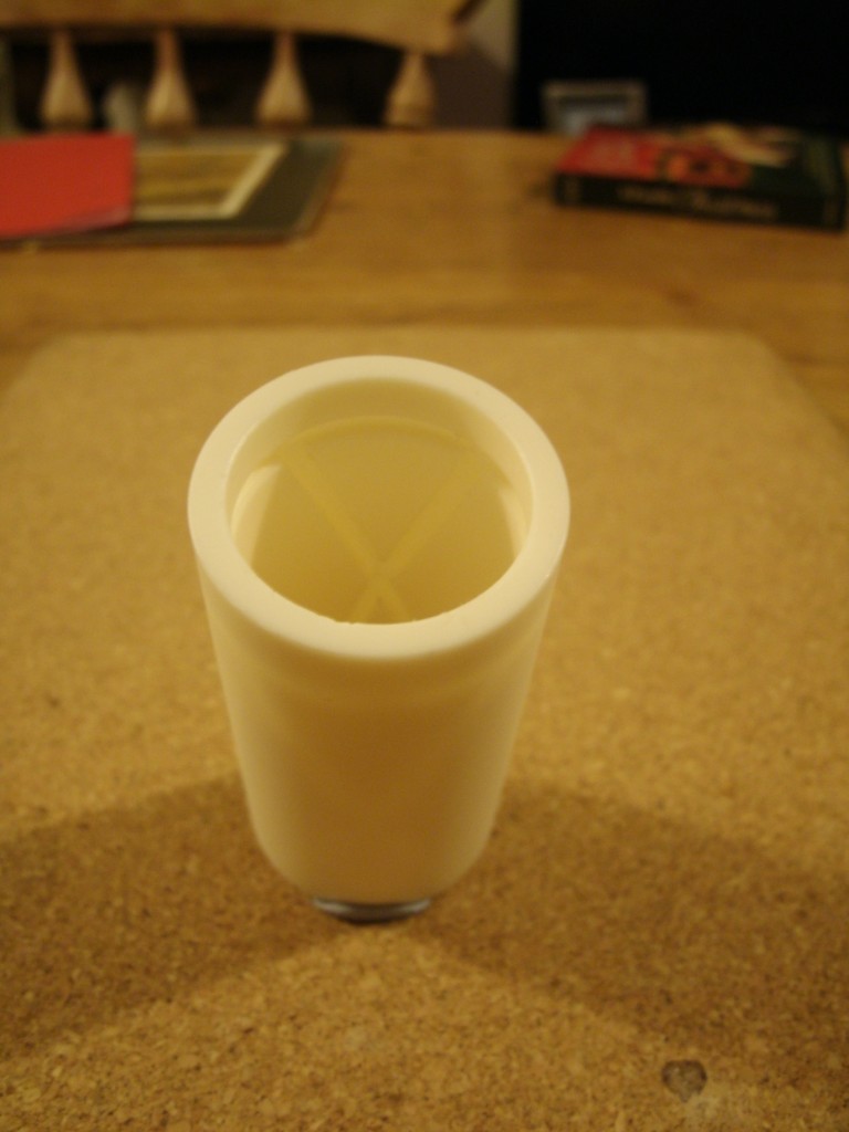

For those who are interest in the use of Vesconite Hilube for bushed, then this subject was covered back in 2014 Front suspension longevity
Originally Posted by bilibib
In response to Lecats post(I think)I have attached some photographs of the Vesconite Hilube bushes that I have fitted to my 4/4's Stub Axles, the Bushes I made have 2 pairs of opposing helical groves connecting to a annular groove at the one end thus allowing the lubricant to circulate with the rotation of the Stub Axles about King Pins, although in theory being made with a PTFE filler the Bushes should not require this amount of detailing, but I am a belt and braces man. The Bushes were made for a resultant fit in the Stub Axles that line bored at both ends,leaving shoulders for the Bushes to register against, avoiding any axial movement of the Bushes when fitted. I also bored the seating for the lower Bush to accommodate a Lip seal that is shown in the one photograph.the outcome has been as I hoped with a close transition fit with no reaming
Instead of using a bespoke PTFE wiper I used a standard lipseal, which has proved simple to fit and effective

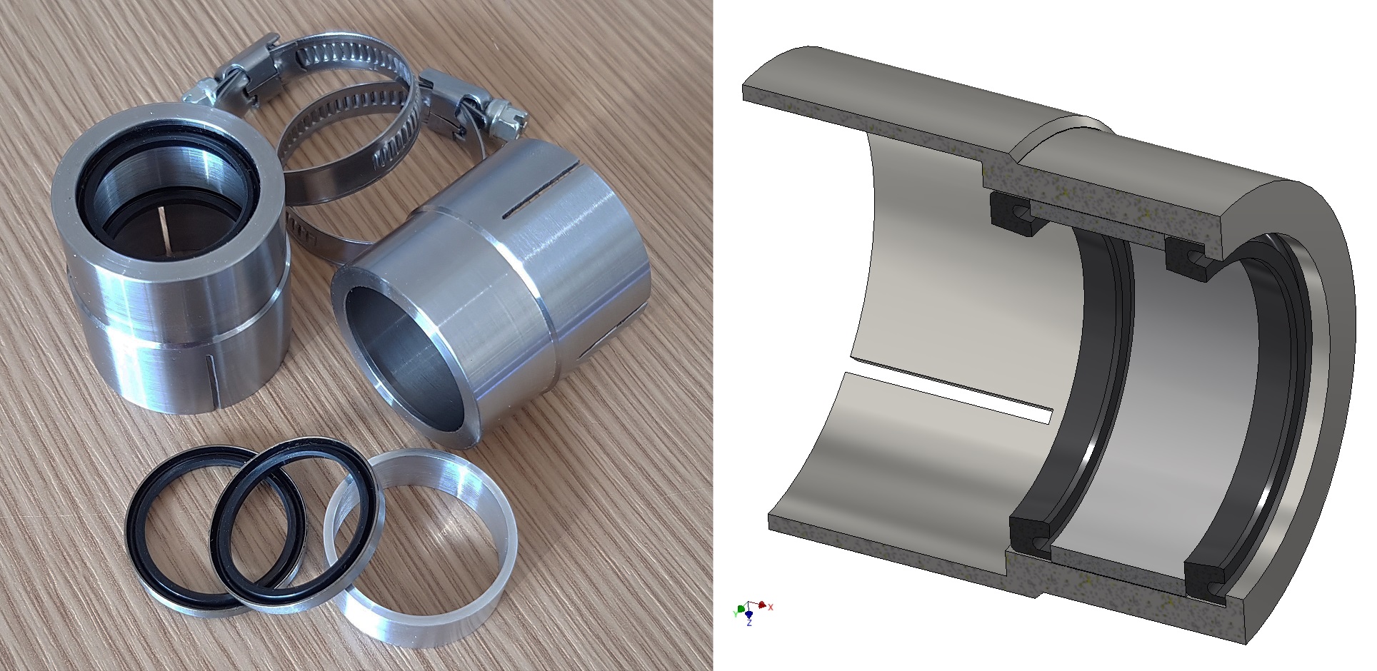

When I purchase my second car and got it home I spotted that it had the RS front end. A bit of a surprised but opened up another opportunity. I noticed that it used a little 10mm spacer between the lower spring and hub. Enough room to introduce some sealing perhaps thinking
So now I’ve abandoned the PTFE wipers and have these retro fit able wiper seal housings that replace the 10mm spacers above the bottom springs. There’s enough room to fit 2 proprietary wiper or scraper seals per pin. The seals have a little radial float as the outer of the tubes may not be absolutely concentric with the pins. Haven’t had the opportunity to fit them yet but it should be a case of just removing the bottom springs and attaching them to the lower part of the tubes. Fun to come playing around….
With regard to your beautiful lip seal housing, would it be necessary to shorten the rebound spring when fitting ? As I am thinking ( and I may have got this completely wrong) that the lower section of the stub axle, against which the rebound spring would normally locate, now is mounted against the internal shoulder of the housing with the rebound spring now resting upon the face at the end where lip seals are mounted. But I am unsure where the " 10mm spacers" that you remove come into the scheme as there are no spacers fitted to my 4/4

No there should be no reason to shorten the springs. The RS kit is a little difference to the regular arrangement. On this car I have a height adjusting spacer below the stub tube. The plan is to ‘attempt’ to substitute the housings for the spacer, we shall see…. smile
PS - Sorry it’s actually a 20mm tall spacer not 10mm, I posted way too early this morning….!
Having had your Hilubes in for a while, how do you find them?
