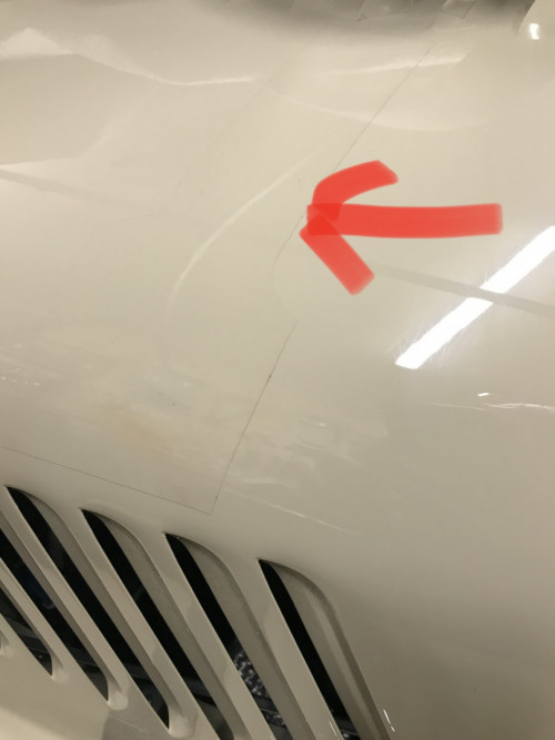

Mine is a plain leather strap with no fancy backing so I used paint protection film under it.
Not wanting to widen the thread so soon but ... I want to fit a wider strip due to the considerations mentioned above ... any tips for removing the old stuff before I start?

Try a hairdryer, and slowly pull it back over itself. So from the bottom edge pull vertically up.

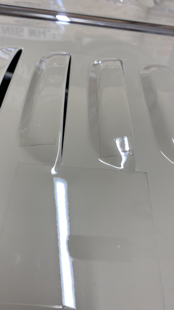

Even with a polished alloy bonnet I have ppf fitted. My first Roadster had a painted bonnet & a bonnet strap which I removed. The edges of he louvres has lost paint but the rest was OK despite no ppf but this was after 9k miles only

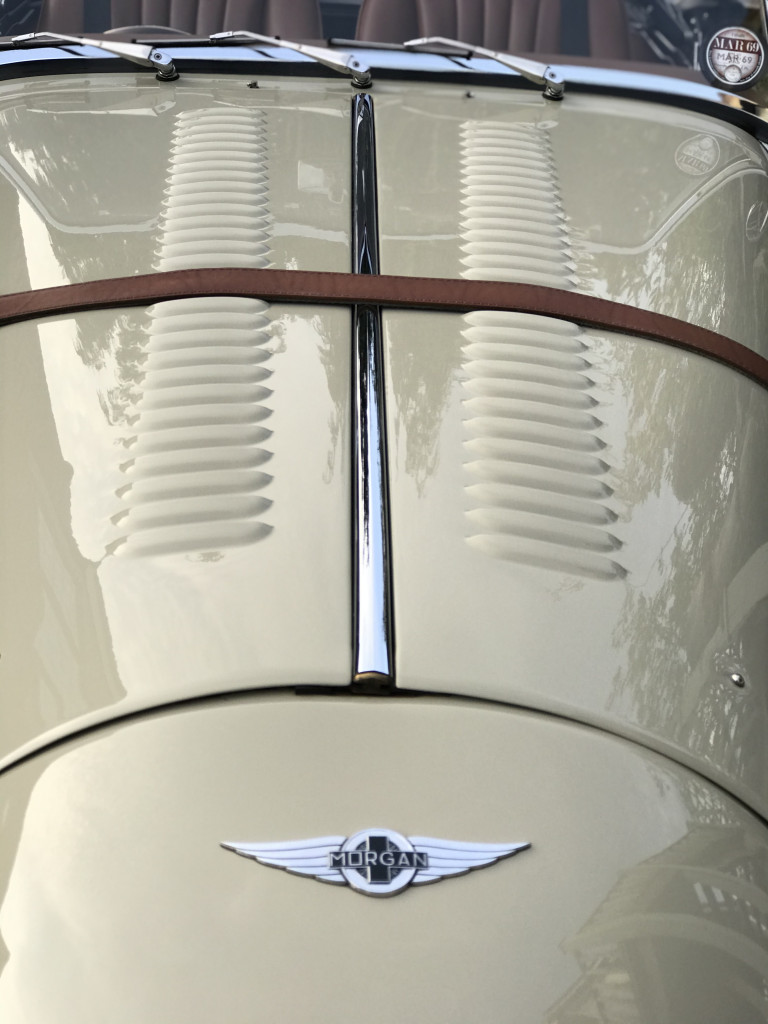

I applied ppf under the belt

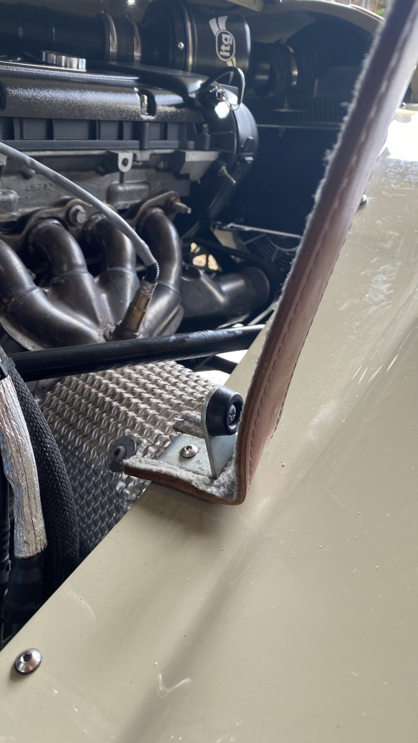

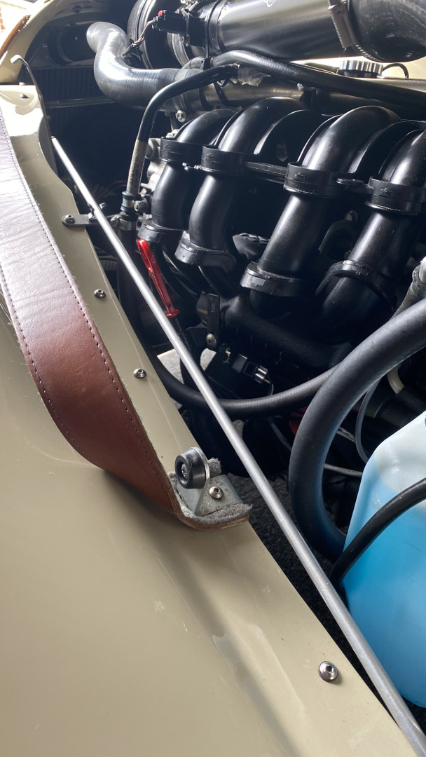

Hi Craig,
could you post pictures of the hood belt anchor points?

Hi Craig,
As requested

πŸ‘ŒπŸΌπŸ‘πŸΌ
