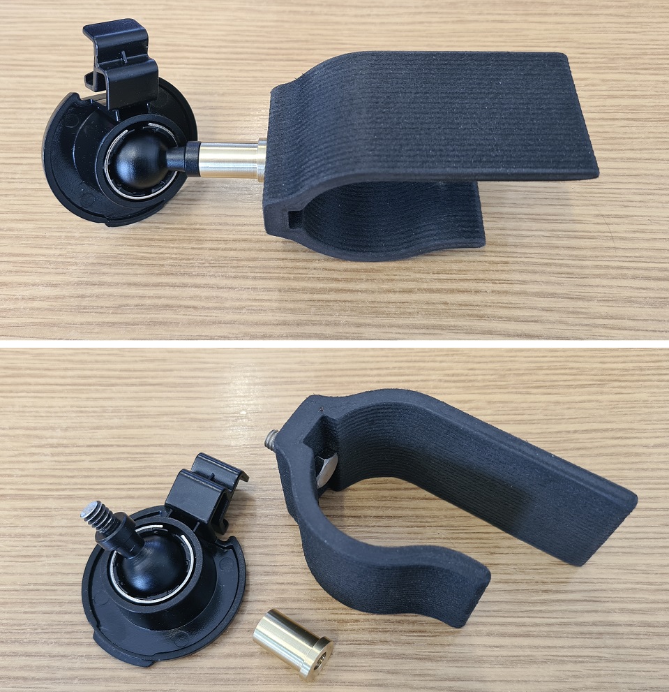

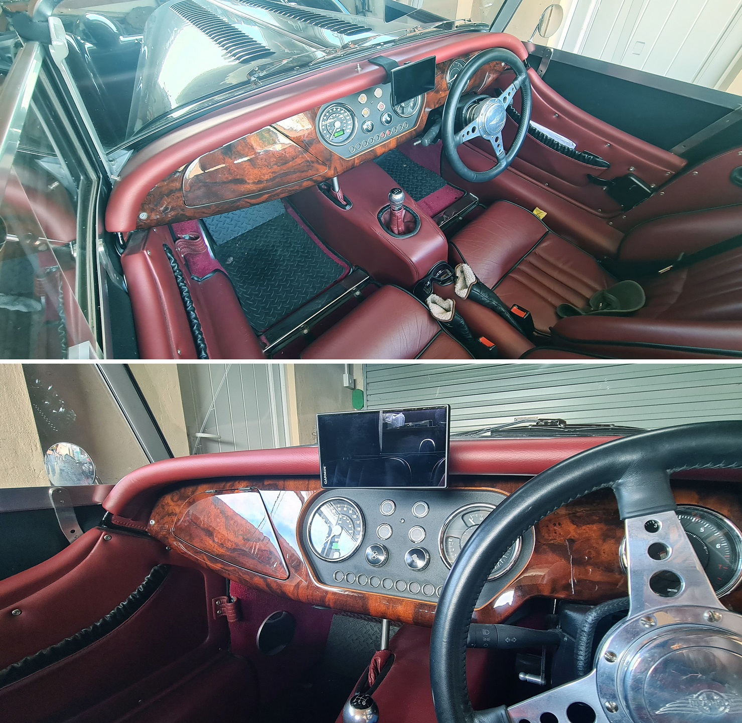

Might as well toss this in. Not for a CX but might fit the same and would equally work with a telephone. It uses a printed clip that fits snugly around the top dash profile with a little turned brass adapter that fits a 17mm ball thingy I found on ebay. It ‘springs’ on and off and can be slid along the dash to any position.

That looks superb Roger, I can't find anything like it on ebay, have you any more details at all?

Also a super solution Roger. Where to get this plastic clip with dash Profile on eBay?

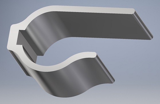

Sorry chaps it’s not on ebay its a homebrew. I printed the clip after modelling it around my dash profile. But if anybody is able to print and would like a copy of the STL file they are welcome.

Thank you for the file Roger 👍😎
