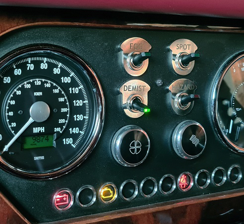

My 2011 car is fit and well again after long awaited surgery to remove a failing dash pcb. Sorting the infamous pcb has been on my ‘to do’ list ever since the rear fog light decided to permanently stay on just before its MOT. When this multi-function item starts to play up the options are stark. When I enquired about a replacement about a year ago I was told they did still have some but £754 + vat. Also I believe the original manufacture Zonefollow now no longer exists. So the perfect excuse to attempt its removal and replace it with something a little more, ‘low tech’ and ‘future proof’.
The results so far. From the outside there’s only subtle changes. The vending machine switches have gone but still looking mostly original.

I did have to knock up some stainless bodge bezels to hide the huge Ø23mm holes left over in the dash panel for mounting the previous switches. The toggles only need small Ø12mm holes and I didn’t want to remake the panel.

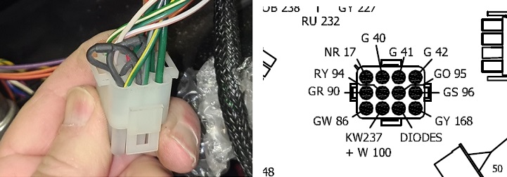

Gordon just a thought… Richard may be better able to answer this but on later cars I’ve noticed they’ve stuffed what appears to be a couple of fly back diodes in the back of the pcb connector on the blower high and low pins. Could a faulty diode cause your symptoms?
PS - and I believe it’s a 15.1A rated motor with a 15A fuse.

100% functionality Richard. Even my toggles light up smile

Re Gordon's heater fan fuse issue, can't see diodes themselves being an issue unless they were used for current limiting. Will look further but little harm in trying the next highest rating 20 amp fuse.

Wow! These switches look so cool with their ilumination.
