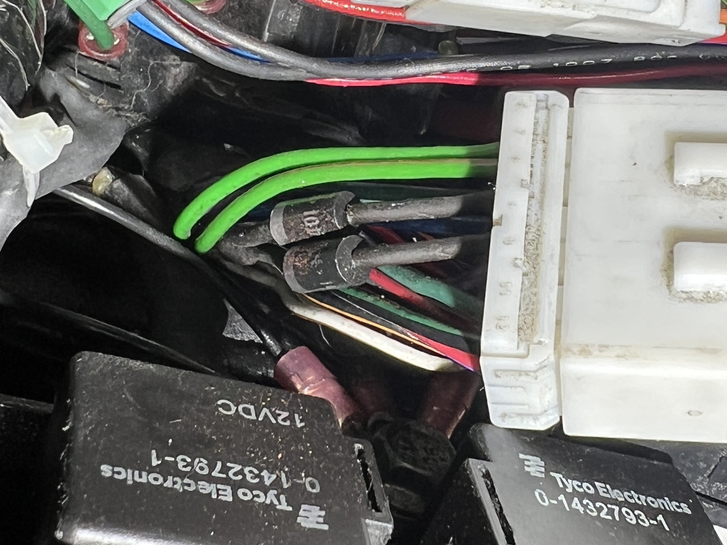

Firstly the diodes are a long shot but being IMHO something of an afterthought bodge (since they are not used on 2014 on models) come under suspicion. The wiring schematic shows them on the chassis loom connector to the dash switches so wherever that is you should find them, likely covered in heat shrink. They will be fitted to the standard green/white and green/red indicator wires.

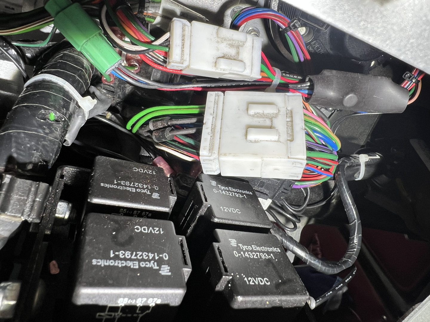

@ Lee the diodes are just outside the loom near the fuse box. You can see them, but you need to learn how to test them as it's such a short piece of wire where they are on.
I will try to make a picture so it's easier to find them.

So far as I know, are these the diodes at the instrument panel connection.
How to check if working correctly without taking the wiring apart?
