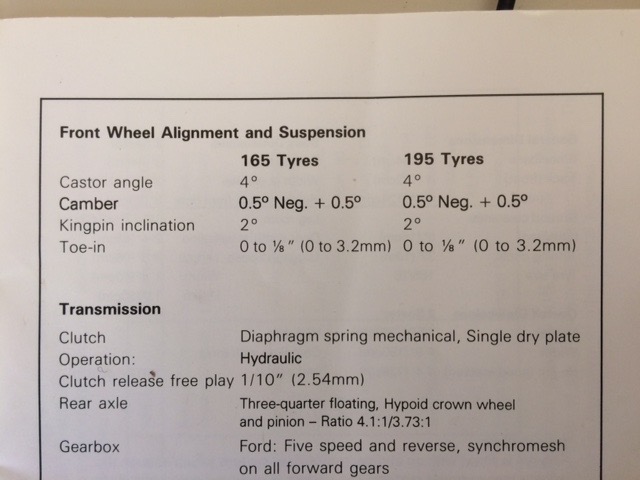

I Stand corrected but according to my handbook it's 2 degrees. Morgan Handbooks Huh
If your figure is correct, It throws out my track rod angle roll steer calculations because my track rods are at about 4 or 5 degrees which I've been comparing with 2 degrees kingpin inclination. I thought I had measured it already but I'll check the KPI again.

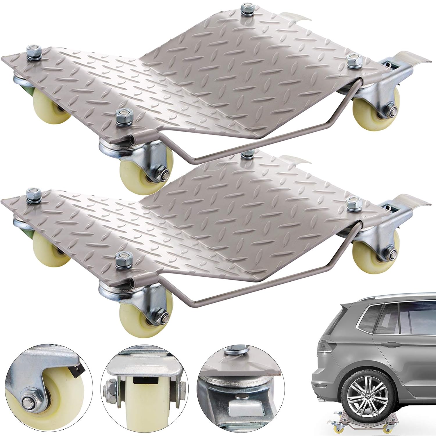

Posts: 14,748
Posts: 14,748
A pair of these, or similar, would do the trick if mounted with the wheels sideways
https://www.amazon.co.uk/FlowerW-Dollies-Positioning-Bearings-Recovery/dp/B07YXWF494/

Originally Posted by SimonH
Remember the stub axle isnt at 90 degrees to the kingpin...
Simon @ SiFab.co.uk
I know, in theory it is 91.5 degrees if the camber is 0.5 degrees negative and the kingpin inclination is 2 degrees.
However, it is the kingpin inclination that determines the sideways bump movement and it is this angle relative to the track rod angle that affects bump and roll steer. I will get round to measuring it again but I would have sworn it was about 2 degrees, hence the bump or roll steer tendency with the track rods at about 4 degrees.
And the more it rolls the more pronounced the steering effect which is why I readjusted the spring seat height to minimise it.
Of course I could be wrong so you can explain where my thinking is going awry if you've got nothing better to do at Race Retro.
