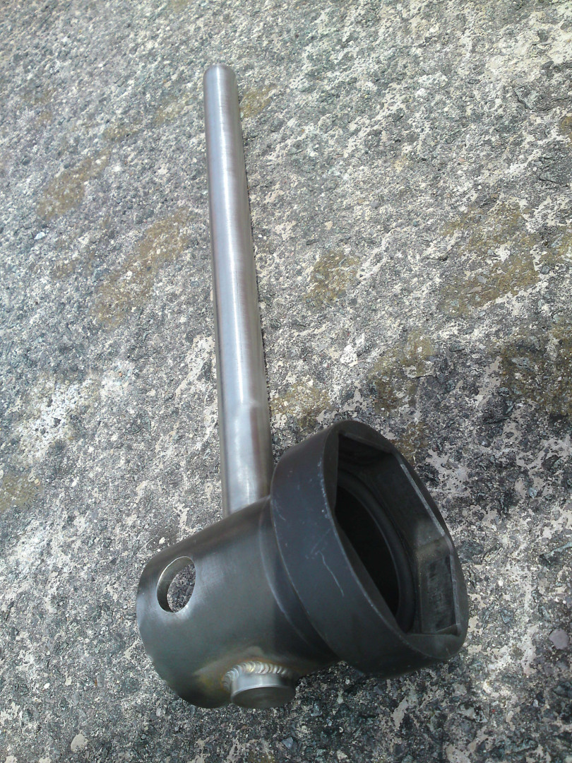

I have them on my Plus 8 and I modified the supplied socket and drilled the extension on it and welded a half inch by two foot bar on it, this is sufficient for tightening but you need a scaffold pole fitted over the modified socket to remove them - not a roadside job but it's worked for me for nine years.

I have them on my Plus 8 and modified my socket to take a long bar / Torque wrench . Very happy with them as they are well made and I am always a little wary of wires . The fitting and removing experience is the same as that of Rich above .

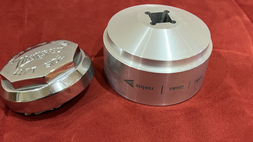

Thanks guys - Richard - where did you get the socket from and what size is it? Nick
Posts: 37,481
Likes: 989
Posts: 37,481
Likes: 989
Nick, it came with the car but sans a bar doh I have never measured it before..
It's 3" or 77mm in new money.

The dimension is 70.15. I have already turned and milled such bases.

Clemens, with respect yours are the standard size (a lot smaller by 6.85mm) but the very Limited Edition Morgan Lightweight Alloys have a totally different sizing hence the OP question.
