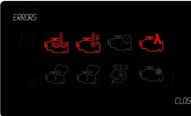

1. AutoTune
This feature allows you to apply suggested changes based on the logs you've taken over hundreds of miles to get the base fuel table as close to perfect in relation to your predefined target Lambda table, logs are recorded on an pre-formatted SD card you insert in the EDL-1 data logger.
The more you drive, and specifically the more you drive under different speed and load conditions, the more samples are taken by the logging software, the EMU Black actually shows you the number of samples taken in each cell which ensures you're covering all bases. Better still the Ecumaster EDL-1 data logger is also a Bluetooth transmitter, using Ecumaster's own app you can now use your phone or tablet to view a huge number of data streams across four pages of user predefined sensor feedback.
Here's one I made earlier:
It'll even give you a series of engine management lights to replace the MIL light that's now missing as we're no longer using the factory OBD system.
