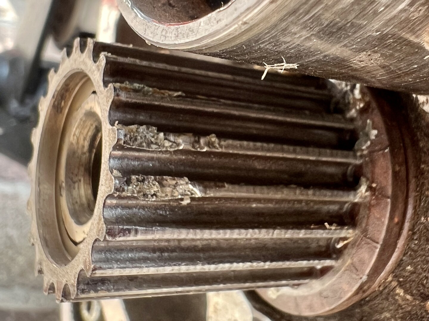

This week, I also had a broken belt despite it being an original Gates. I found this on the crankshaft pinion when doing the roadside repair. Absolutely no idea what has caused this damage. I can't imagine that parts of the broken belt could cause this damage.
I ordered a new pinion and a new spare belt. When carrying a new belt, please be sure you have all the necessary tools to repair the road.

The failure that Laurens shows in his photograph above is, I believe due to the fact that the timing sprockets appear to be "Sintered" or produced by a process known a "Powder Matallurgy".
In this process metal powder is compressed into a mould and then heated to allow the metallic grains to fuse together. The process has to be very closely controlled to ensure maximum strength in the finished component and if the powder is not properly fused together this can result in the final component having less than the required strength.
I recall some time ago people were experiencing failure of the keyways in the pulleys for the same reason.
The following website has the details :-
https://www.pm-review.com/introduct...tering-in-the-powder-metallurgy-process/

Another good reason to have a clear viewing window in the belt cover. You would be able to see particulate before the failure, hopefully.

Those driving gear teeth appear to be wider in the area of the damage, which would tend to indicate a very solid object passed between the belt and the gear. Are running spacers on your front cover or is there any opening that could have allowed a foreign object to enter the timing case?

Yes, the normal spacers but they give only a slot of 2 mm.
