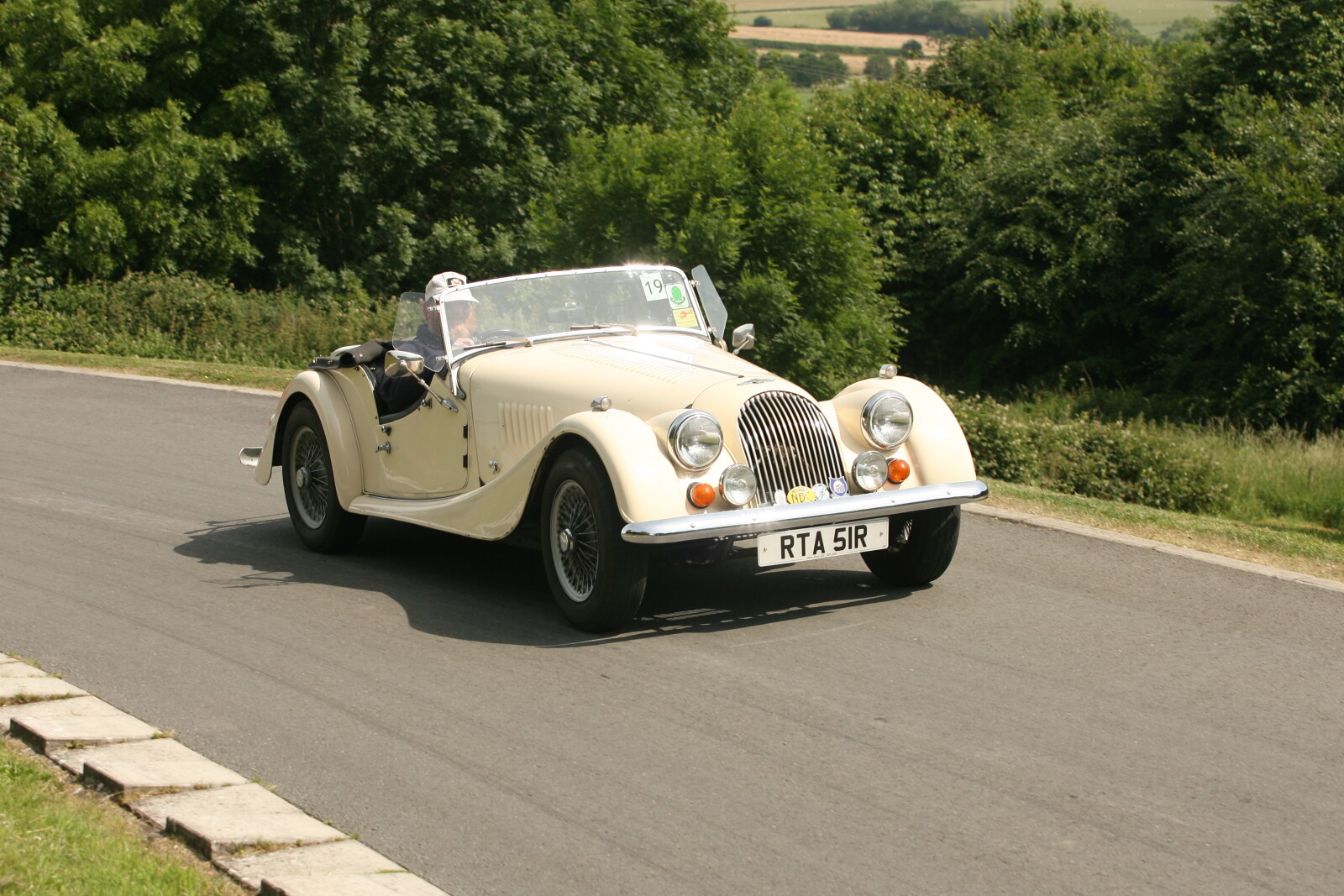

There is more straight line before the finish if you don't turn in so early. Stay out wide, to the left, on entry and turn in tighter once your view of the corner starts to open out. Should mean you kiss the curb just at the ext of the corner giving a longer straight line to the Finish line. smile
But as Keith says don't go too wide. A long time ago (long before my time) there used to be hedge around the outside. However. one day one Sidney Allard went through the hedge, which became known as Allard's Gap. Eventually others widened it (or created their own) so the whole hedge was removed. So long as you are upright that slop is not a major problem, with a bit of a track at the bottom of the steep part and a gate out into the top paddock grin2

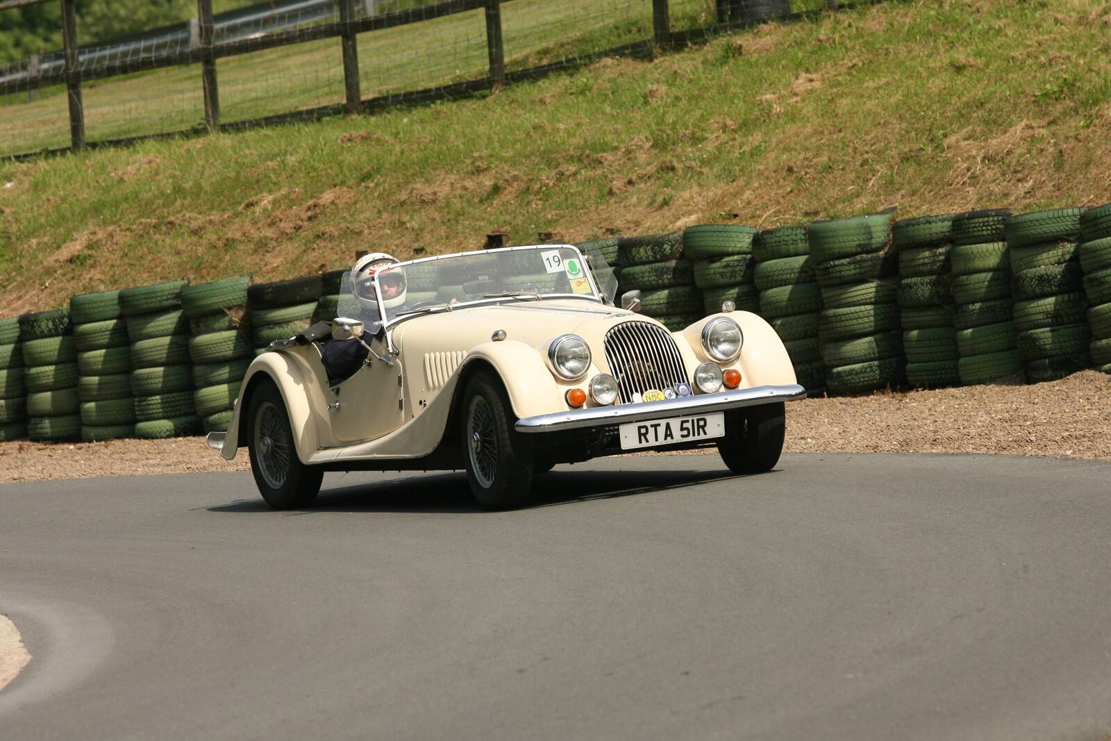

I've turned in too late here and should be a couple of feet closer to the dragons teeth:

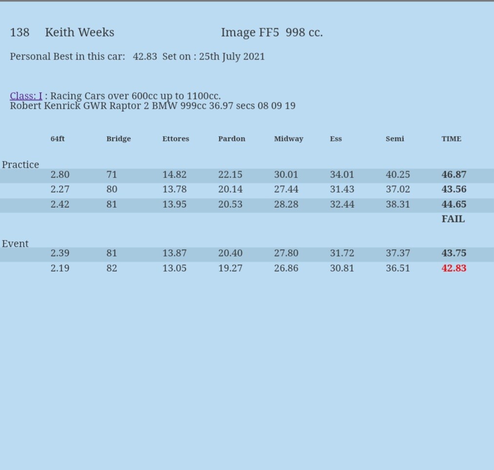

Not sure if they had the full timing going when you were there but on competition days there's six 'splits' , speed under the Bridge and Finish time .... means you can beat yourself up about the time you threw away on every section of the track!! 🤣 ... then it really gets a grip!

I presume your reference to hairpin is to Ettore's, the right hander. Again your turn in was far too early. There is an adverse camber here, to carry best speed through the corner your entry point is fully out to the left hand side (in this view I've already started the turn in just after the start of the corner):

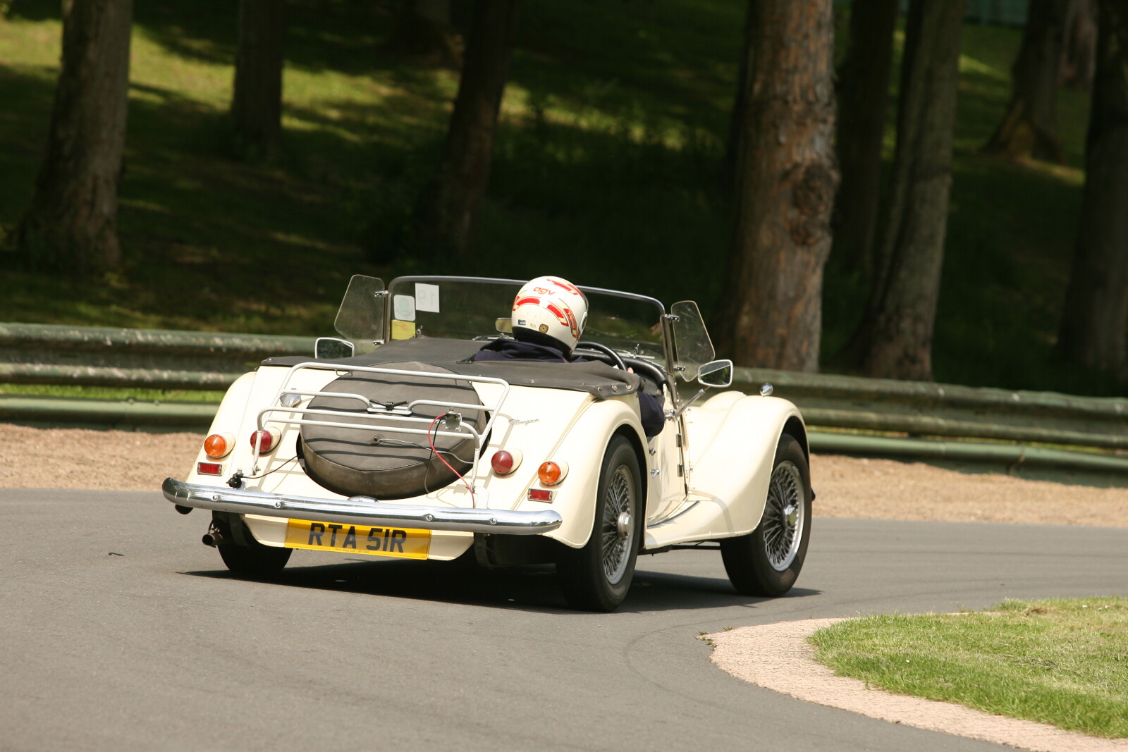

By the time you are half way round you should be roughly centre of track, your exit at the end is also your apex - not reached it here:
You then straight line kissing the track edge on the left by the left hand kink on the downhill towards Pardon hairpin.
You can already guess what I'm going to say about entry to this from my other comments. (and it's not entry on the left hand side.. )grin2
