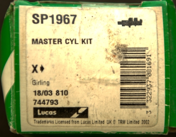

I am looking to rebuild my old master cylinder which I kept after fitting a new one some years ago. After seeing the eye watering price of a new one can anyone tell me the part number for the Lucas/ Girling service kit. I have the fitting instruction paper which reads ZXB 103 ASAS and the first three part letters and number SP8?

When I bought my mid 80`s +8 one of the first set of spares I collected for it was a full set of hydraulic seals. I have no idea if the MC on your Mog might be the same dual circuit type as mine but the green Lucas box identifies the kit as SP1967 also there is the name Girling on the label followed by 18/03 810 and below that 744793... Hope this helps and does not muddy the water..

Happy to post a pic of the label and the contents of the box if that might be of any assistance or indeed a pic of the M/C as fitted to my +8 to assist with comparison.. Whatever..(-:

Thanks Luddite, I have a kit but with missing part numbers could you send me a photos of the part number on the box you have.

I will try to post an image in the gallery section..

Have taken the liberty of posting the part number image below.
