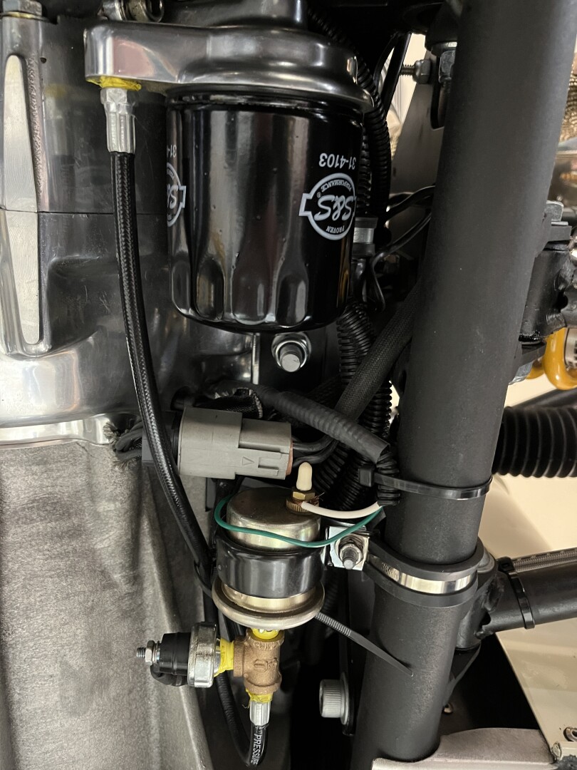

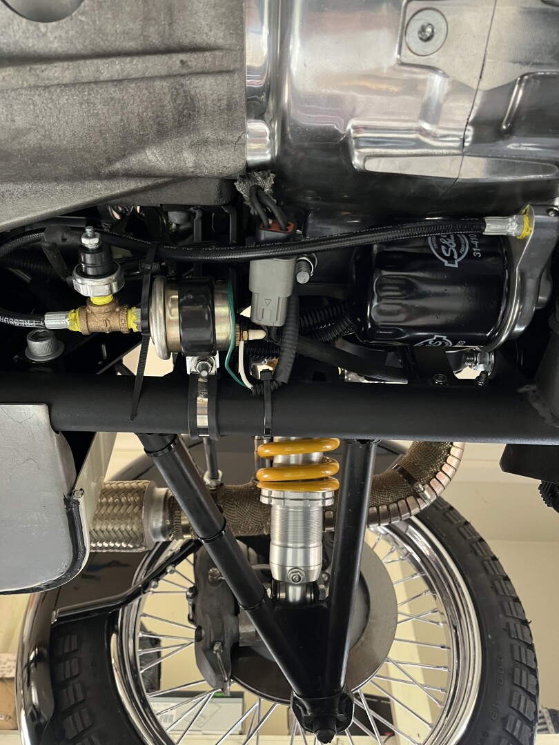

Rather than mess with the oil feed/filter system I used the oil pressure switch port to take a flexible grease gun line to a Tee fitting off of which the sending unit for the oil presssure gauge is mounted AND the S&S oil pressure switch. Seems to work fine and I think I have the merlin sports oil mounting plate is someone is interested in the USA.
The gauge is mounted under the dash below the GPS unit and is to the left of a real fuel gauge.

That is a really smart installation Lightspeed. I like that tucked up out of the way and isolated from the direct vibrations of the engine.

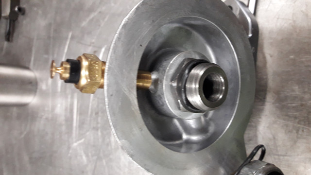

By modifying the oil filter bracket with two holes and 1/8 npt threads this simplifies the installation of a pressure probe and gauge.
Thank you Planenut, one of the reasons i did it that way was to tuck up the birdsnest of wiring that MMC left behind the oil filter can. Now getting the filter off is a bit easier.
