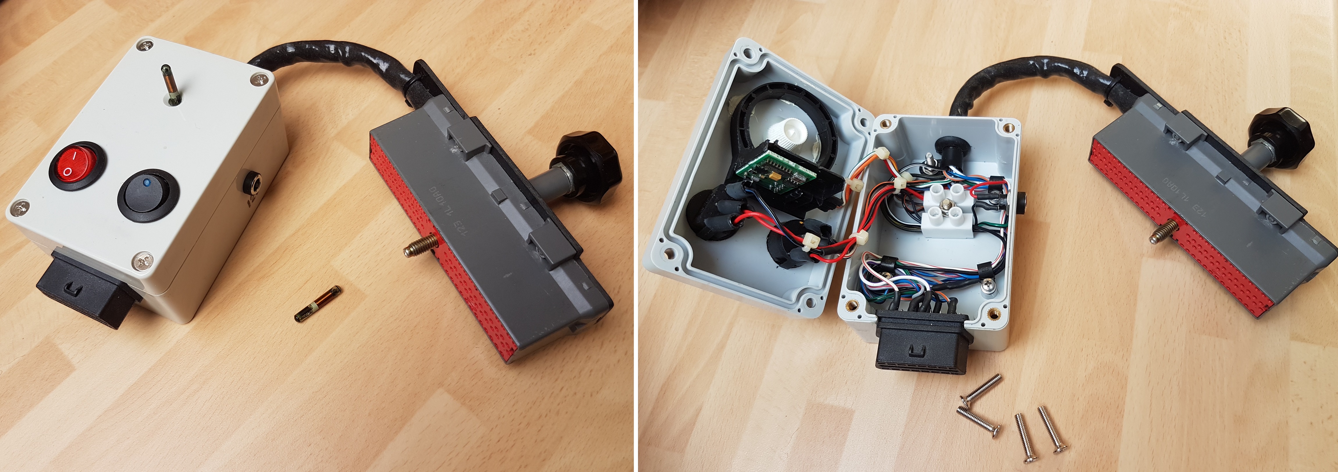

No they don’t need to be married. I’ve been using one from a Mondeo in my home made ecu/chip programmer thingy. A slightly different form factor to the one we have but works fine with Morgan ecu’s.

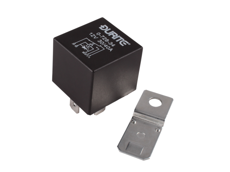

I think that part number has been discontinued now Ian. I replaced fuel pump and ECU relays with known quality Durite 12 volt 30/40 amp diode mini changeover relays when I had an intermittent issue on my Roadster. Important they have built in quenching diode. Source below.
