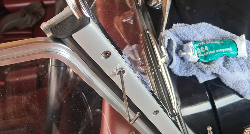

Originally Posted by Ray748
Has anyone had corrosion on their A post?
Galvanic rot I fear. Those little holes make super electrolyte traps. My screws are bedded in (not over tightened) using DC4.
PS - It would be fairly straight forward to have these investment cast in stainless, with iether a nice satin or polished finish shades
Roger

Originally Posted by Rog
[quote=Ray748] Galvanic rot I fear. Those little holes make super electrolyte traps.
WELL DONE! You are smarter than the MMC and I have been.
I rejected the galvanic thing as the coating is neoprene, not thinking of the Morgan goto of a galvanic reactions with fittings.
Thank you! If you would like a gomog credit, send me a PM.
gmg
P.S. I changed all fittings on my last Morgan on arrival. Jw used to sell a complete kit for that purpose, using polished ss. They come in classic screws rather than machine screws the Factory began to use in the hard era to save time.

I had this problem several years ago with my Trad. After a proper repaint, no more corrosion occurred.

Worth allowing a dribble of ACF50 to 'wick' into the holes a couple of times a year

It would also be a good idea to remove the screws one af a time and coat with Duralac. Actually it is a good idea to do this for all screw / bolt to Ali fasteners - door handles , side screen fittings, light fittings et al.

Mindful of the corrosion that can occur on the windscreen stays I too removed setscrews one by one, cleaned and replaced each with a good splodge of grease.

Originally Posted by DaveW
Phil Ledgerwood sold chromed A posts on an exchange basis around 2009, but the finish didn't hold up over time so they were discontinued. The Allen bolts just need removing and apply your favourite "solution" whether that be Coppaslip, ceramic grease, vaseline or whatever. Then just watch closely for the merest hint of corrosion. The finish on those A posts varies. My 2005 has an almost Hammerite look, which may or may not be original. It hasn't shifted in 19 years. My 2016 has a sort of battleship grey semi gloss finish. It's still OK after seven years despite the worst Scotland could throw at it.
The point is this. If you pay over £70k for a car, corrosion of the A posts after such a short time isn't good enough.
I have found that when it comes to corrosion, Nature always wins especially in humid places. It is easier to make metal-on-metal decisions using a Galvanic reaction table, which I have just freshened up for you on gomog for you. Grease and miracle sprays only work for a time and when you find they have failed, rot will have irremediably spread especially in a damp climate as water is a rot catalyst. It is less hassle to go with nature gave us than fight it with face creams. smile Same advice I give to my wife! hide
There are only two types of the subject bracketry that, IMHO, have been absolutely gorgeous and long lasting. The pre-1977 chromed bronze. These were followed by aluminum-sprayed bronze (a saving), then aluminum brackets which could be polished (sorta) and finally, upto a few years ago, the UK aftermarket offered polished stainless steel from John Worrall, (along with great ss Morgan fittings of all types). Though polished stainless is less lovely than chrome, it is bullet proof where chrome will eventually flake off and is fragile in impact. Lastly there is neoprene coated ...er...metal (the ultimate saving before plastic) [shiver]) But regardless what you have, you are always safe if you follow the Galvanic table and you are told the truth about the metals you put together.
For example, for aluminum supports, use aluminum screws. I used chrome screws with my chromed ones and stainless steel screws with my stainless steel ones. I never had a single problem in this area with ANY of my mogs, be those in North American or the one I kept UK/Europe. Isn't that wotth waiting a couple of days. The cost is negligible considering the look and lack of rot risk.
I dislike carrying more than I have to when mogging. Though you'd be surprised with what I do carry! Whatever the metal you need you can google to find it a fitting that matches it or the galvanic table laws. I favor the USA's Garner Westcott. (Being Canadian I have no patriotic conflict on where I buy parts as long as they are the most suited.) GW has the world's largest choice of fittings I have ever come across in chromed, graded, polished and Jw has retired. GW serves the collector automobile and motorcycle crowd. https://www.gardner-westcott.com/
And here is a UK source selling aluminum.
gmg
