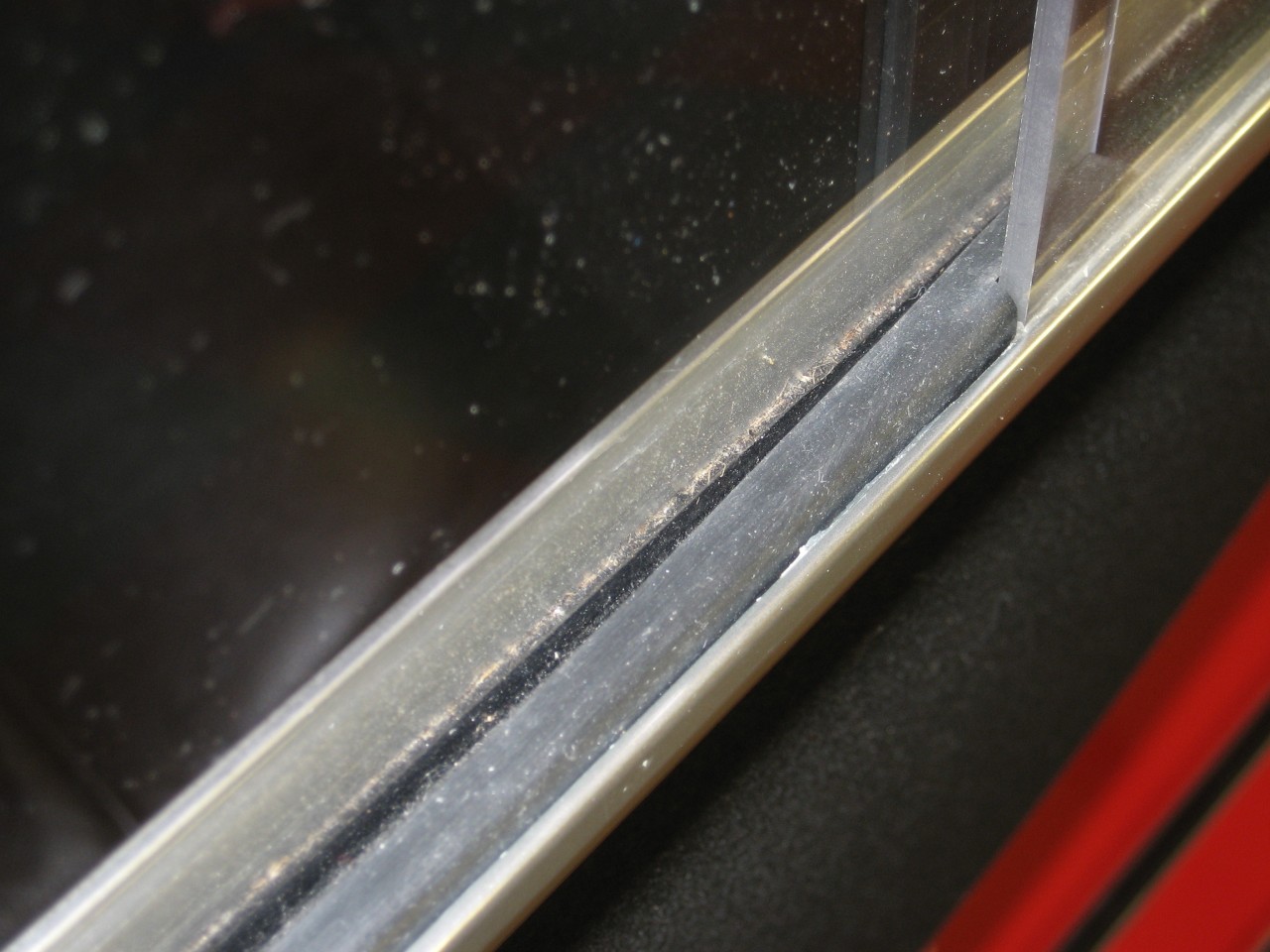

Ssal the stitching with a light rub of beeswax . I checked my side screen drain holes with an interdental stick. Both were clear

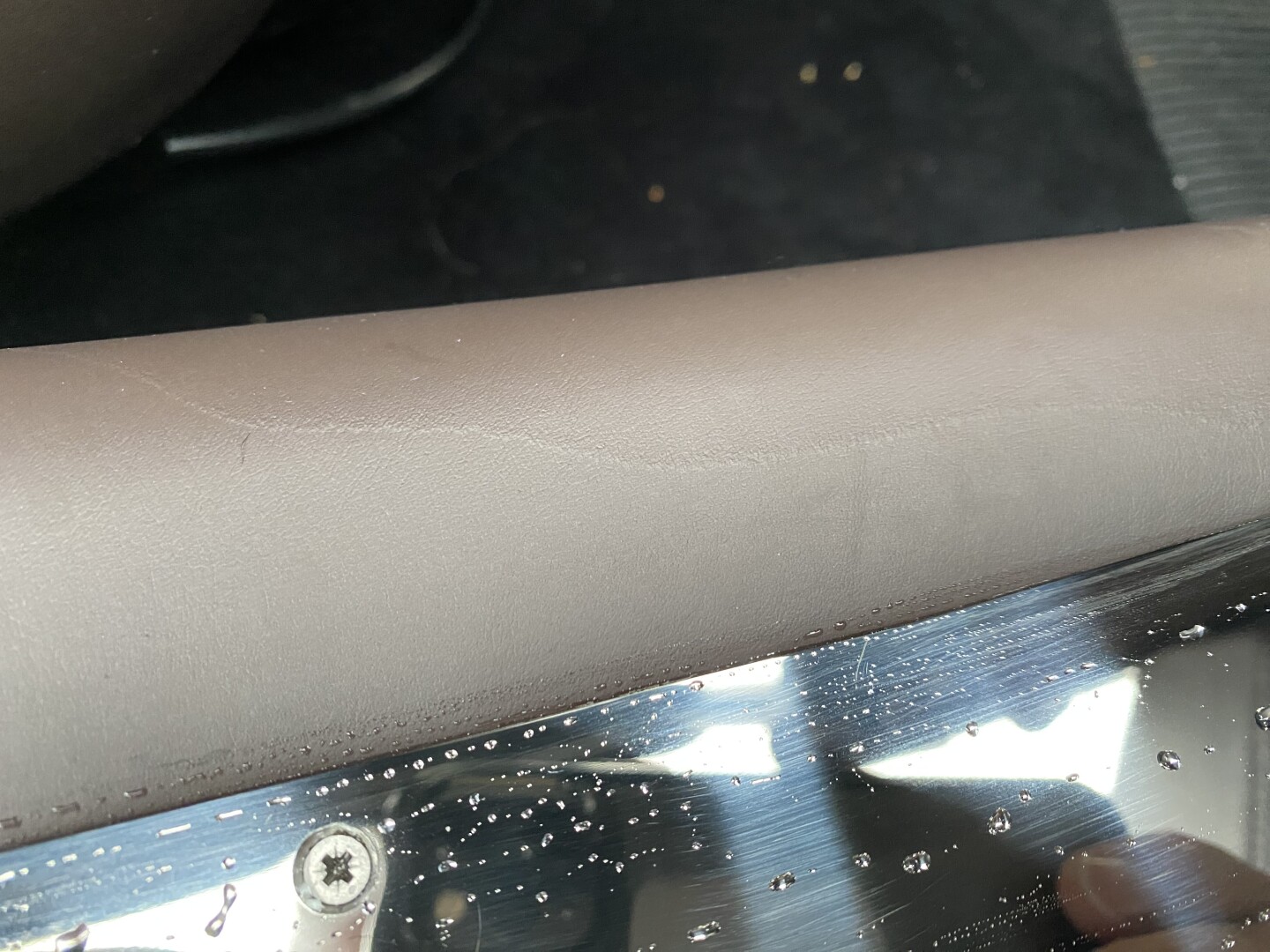

Ok it would seem the blocked drain was not the main cause.
There’s more water ingress and I can see that the leather on the sill already has a tide mark.
When I open either door I notice water pooled on the stainless threshold plates and is rolling in and down.
Do any of you suffer with the same??
It might seem strange that I’m trying to understand the cause but I’d like to point MMC in the right direction or it’s likely to come back not being fixed

Hi Viper yes i get water in the same area as you and yes my leather also has tide marks. It has had extra D seals fitted to front of door by dealer but i am not convinced its water tight as water still appears in chrome strip under door. Window drains were also full of mastic but was removed by dealer at “first “ visit. I know of at least one other with a similar problem.

Ah ok that’s disappointing as I was hoping this was a rare issue.
Will see how it progresses but it might be necessary to run a sticky piece of rubber along the inner edge of the stainless strip to stop water travelling in.

Insert rubber channel here.....it stops 90% of water.
https://cdn.shopify.com/s/files/1/0...NES_CATALOGUE_SCREEN_HI.pdf?v=1654103153
Page 22. Profile IRS0822EP
