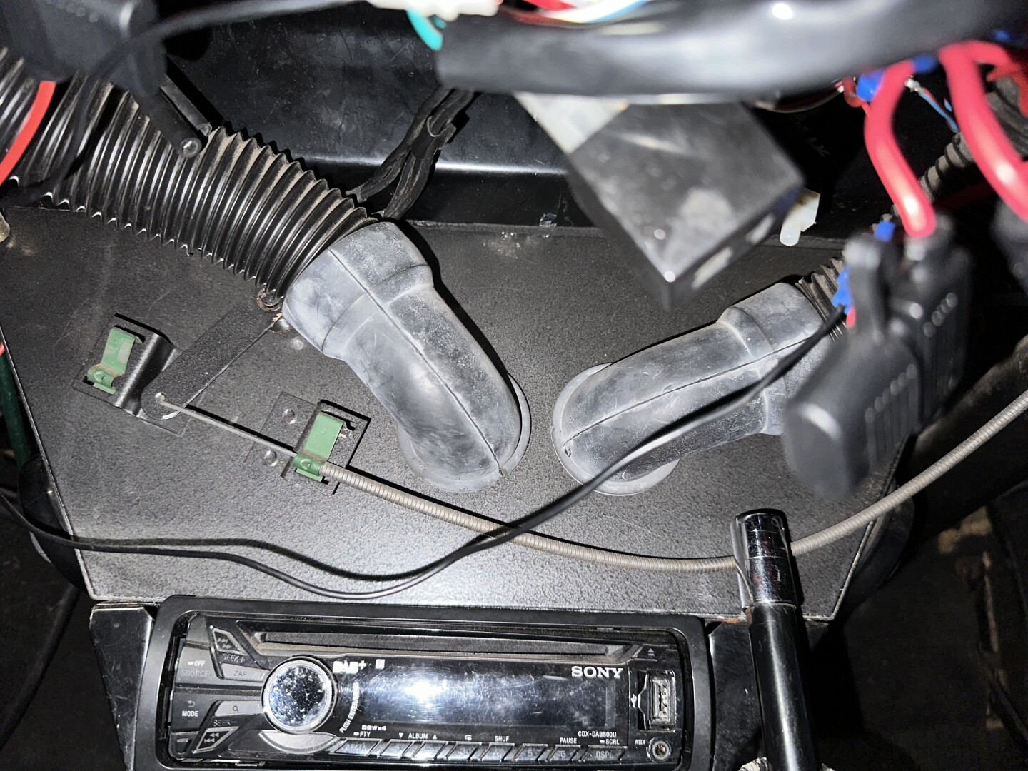

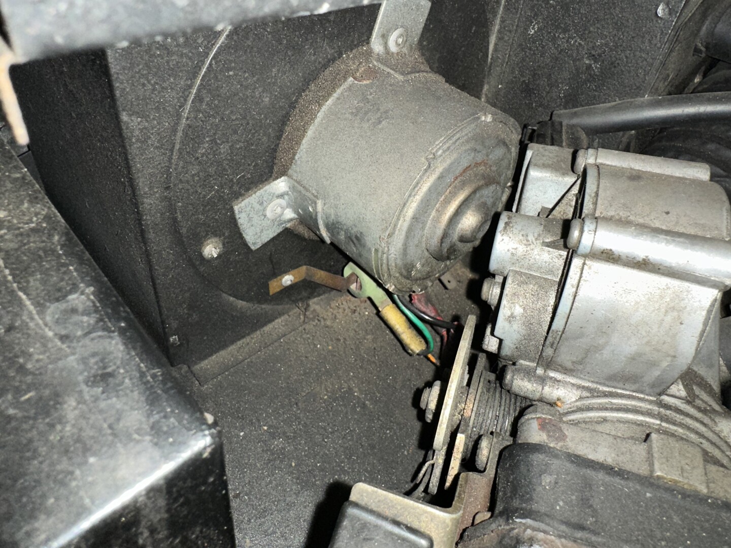

Many thanks all.
I suspect it might be the motor playing up given the symptoms, the output now when on is quite weak..
Pics below:
Any suggestions for a replacement motor?
Many thanks
Will
Posts: 27,860
Likes: 774
Posts: 27,860
Likes: 774
It looks like a lot of corrosion on the wiring. It might be worth a quick spray with connector cleaner before surgery.
