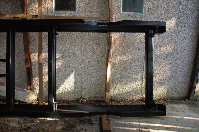

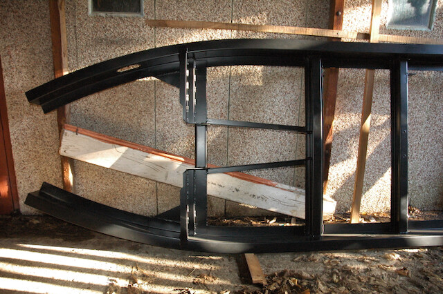

Here are some dimensions from my 4/4. They were built to imperial measurements.
Overall length 152"
Wheelbase 97"
Overall Width 56"
Body Tub width 49”
Height 52"
From Rear of chassis to rear axle centre line 30"
Rear Bumper extremity to rear of body panel 5”
Front Axle centre line to front of wing 15”
Chassis rails 2" x 5" x 2" x 3/32
Chassis width: the vertical components of the chassis rails are 36" between inner faces
Here are a couple of pictures of my chassis taken square on, should help you derive the other dimensions
HTH.

Tim
I really appreciate your help.
This is exactly the information and photos I need!
Thanks again!
