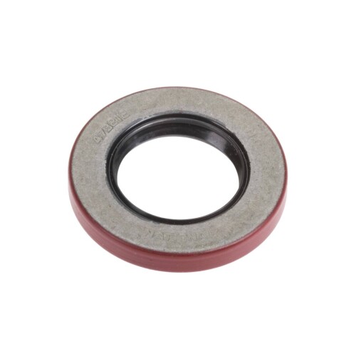

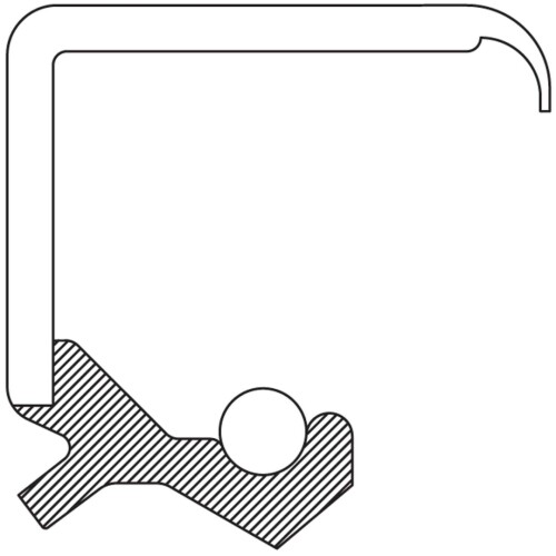

We're installing a Quaife ATB limited slip diff while the engine is getting rebuilt and I'm replacing all of the axle bearings and seals. I have the outer grease seals but still need the inner oil seals. The ones that I removed have leather seal rings and I want to replace them with Nitrile seals. Searching by the old seal's OD and ID, I found that a Timken 473212 is a match and am wondering if anyone has used them. They are wider than the leather seals, but there's enough depth in the housing to accommodate them.
