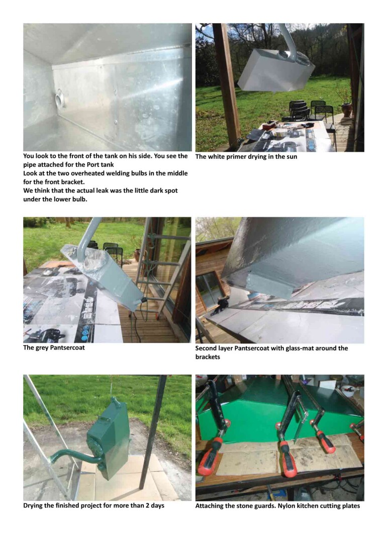

I checked with paper to find out where it got wet.
And found - not to my real surprise - it was the front bracket. I am not the first one and - I will try to show - I am for sure not the last one too.
I am sorry to say – I get a little tired from bashing them so often – but it is again amateur work of Morgan. Cheap as possible and welded by not a real aluminium-expert, I dare to say, I know something about it.
We took the tank out and cleaned it carefully and sanded it.
We found that this welding was one of the worst aluminium welding I have ever seen.
On several places it was welded or heated far too hot so you could easily see that the aluminium got that typical aluminium crumbled texture of overheating.
I found too that you easily could see - inside the tank - that welding of the brackets went through the surface of the tank, which should not happen.
And the welding had made extra bulbs of melted aluminium and/or creating holes. So the problem is there in the first place because of MMC.
And not so much because of movements of the brackets which I read often on TM.

The MMC made Tank
We found several places - even on the plain surface - were the aluminium was over-heated. And the work seems to be done by people without a clue. We really asked ourselves : “Do they went to school?”
The tank is made from one long plate of aluminium and I am afraid not of the right alloy for this construction.
From the front to the aft the plate is bend slightly half-way and at the aft-side twice and back to the front.
At the front are two little slips bend so the front plate can be welded more easily ( See picture ).
Standard but still well done by MMC is that they made just aft the fuel inlet a little bulkhead to break the movements of the fuel.
But . . . it seems that the welding of that bulkhead is exactly the place where you find overheated aluminium on the outside too.
The top and bottom plates are welded on this long bend plate.
So what to do?
Ordering a new tank from people, who clearly seem not having any clue what they do, does not bring you further.
So we decided to make actually a new epoxy tank and using the original structure as a base. This will probably last till the vehicle and we are gone.
There is special epoxy on the market which can help you.
But aluminium is neither easy to paint nor to glue epoxy to its surface.
Want we did was sanding ( P 80 ) cleaning with ammonia sanding again and cleaning and this several times.
When really clean we immediately painted the surface with a special primer.
You really have to prime directly after your last cleaning is dried.
Because aluminium start oxidising directly again and the aluminium oxide will not accept any paint.
This primer has several advantages. Actually it closes all minor holes and hair cracks.
We primed two times with thin but covering layers till the whole surface was good covered. You can do that second time after 24 hour depending of the humidity and the temperature.
After priming we painted the surface again after 36 hours with a special epoxy, which is quit elastic. Epoxy is a glue and when hard normally not so elastic.
We did this – bringing the ‘Pantsercoat epoxy’ over the primer - also 2 times with the same waiting time of 24 hours.
The second time we glued some very fine and thin woven glass mat around the brackets and pressed it well in every hole, corner, etc. So the glass mat was good glued to the brackets.
After again 36 hours we used a normal standard epoxy to cover the whole tank – especially all the welding and corners – with the same thin well woven glass mat.
After all this work we kept the tank drying for several days.
Finally we painted the tank in the same nice rover-almond-green colour of our vehicle. And let it dry again for some days.

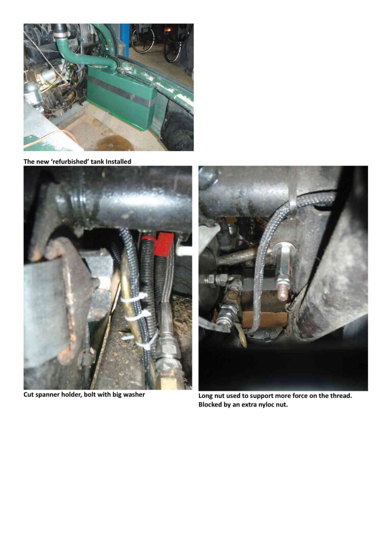

Stone protection
We changed the rotten plywood stone-protection by a simple green nylon kitchen cutting plates of 10mm thick. And glued them with a simple MS Polymer to the new tank. It will never rot again.
Band-spanner
When installing the new tank, we had a lot of problems to get the spanner in place.
There is absolutely one very good thing designed on our M3W and that is the strong made chassis holder of these spanners.
They are so strong build that we decided to cut a sleeve in them so we just could slide the spanner-bolt in it with an extra wide washer, which makes attaching the straps now very easy.
But tightening we were again disappointed by the quality of the stuff MMC is using.
The bolds are not of hard steel and probably that’s the reason many of us have problem to adjust them tightly.
There is a simple solution for it: Give the nut more thread to support.
We used 2,5 cm nuts so the force we use is nicely spread and covered over more thread.
We block that long nut with an extra nyloc nut.
The advantage of using these long nuts is too that you protect the thread better from all the dirt and grease stays in.
