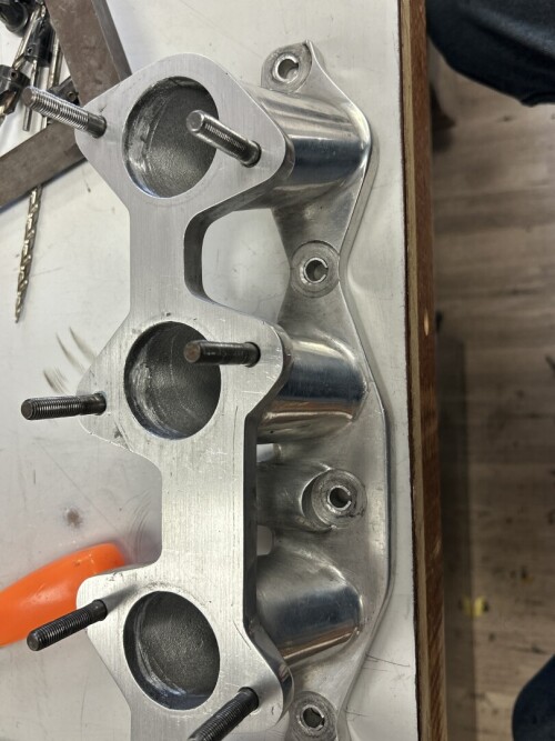

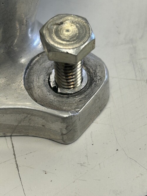

Getting ready to install the intake manifold on the head and discovered that someone had drilled out the mounting holes and there was a very sloppy fit on the studs. I couldn't readily source tubing of the correct size to make bushings, so I formed strips of 16 ga. aluminum sheet around a 5/16" bolt and sprung them into place. It fits much better now.

That'll do nicely Sir!
