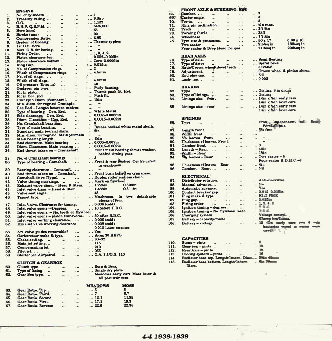

The image below is courtesy of a gift from the late Ken Hill. Even Ken shows nothing after until 1949.

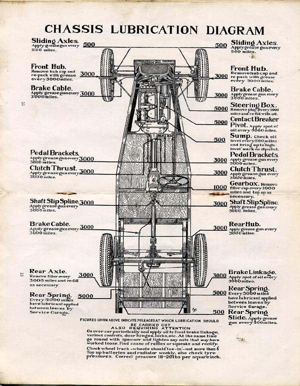

I just tripped over scans of THE 4/4 MORGAN INSTRUCTION BOOK 46 pages in all average page file size circa 150kb. it may have originally belonged to the owner of FLG 280
Circa 2006 I noted a US based website on which many Morgan owners were invited to post details of their Morgan model and their email addresses. The interweb was perhaps far more innocent back then... I noted all the Series One owners and sent them a mail offering to send a copy of the scans of the instruction booklet... some did reply and were grateful to have it.
I also sent copies of the scans to Machiel Kalf at the Morgan historic register some years back...
On the centre pages there was a fold out Lubrication chart similar to the type Castrol used to print which I will attempt to post a pic of.
If you want the scans just send me a PM... Even if you don`t have a Series One there is some interesting reading of the way the MMC thought of themselves and their customers.
