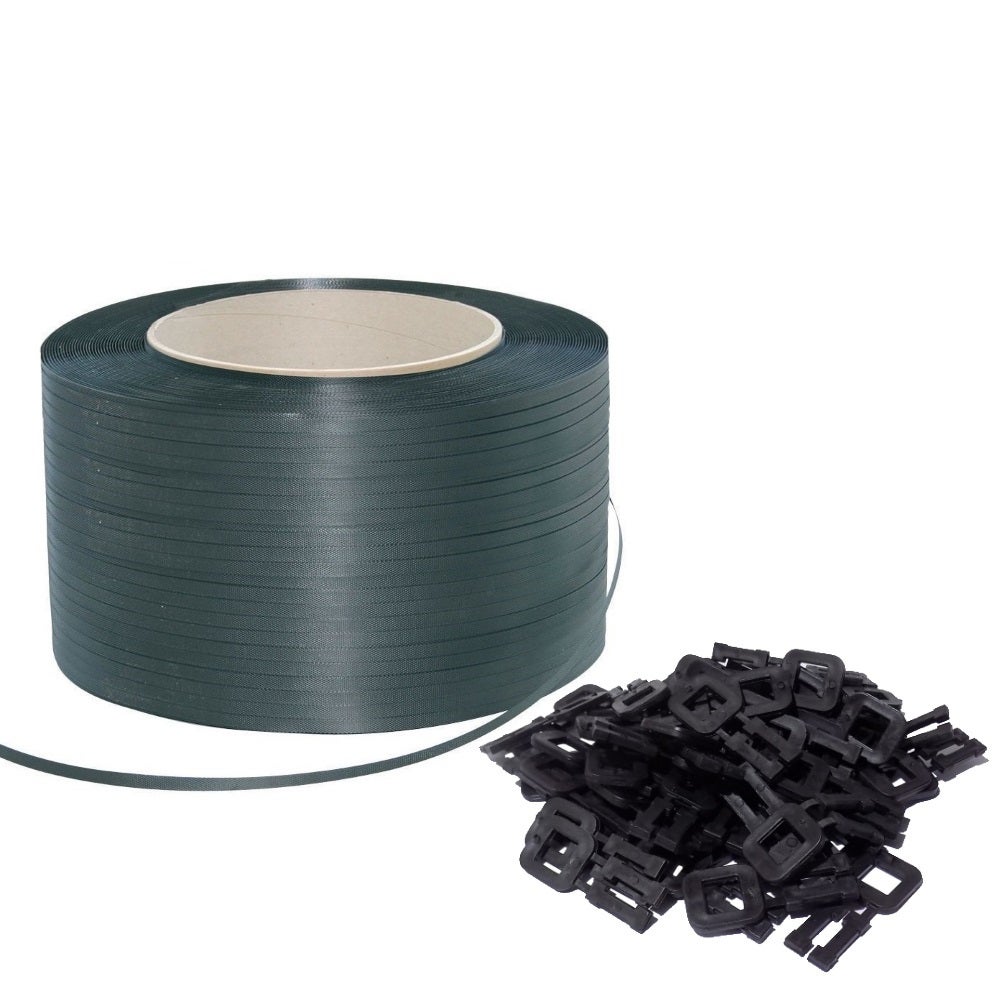

No. Definitely not the solution: too high and too hard. Fitting webbing has got to be the answer but I am not sure if I can work out a way to do it myself with the tools I have to hand at the moment. I might have to try Tim's strimmer line, or something similar. I am thinking of getting some of that plastic packaging straps that you can get with nylon buckles to pull it tight.
900 metres should be enough for two seats laugh

I had forgotten you were up in the mountains wink
Would this be easier, I have used it before as a temporalis grin2 it's easy to tie off on itself and cheap..
